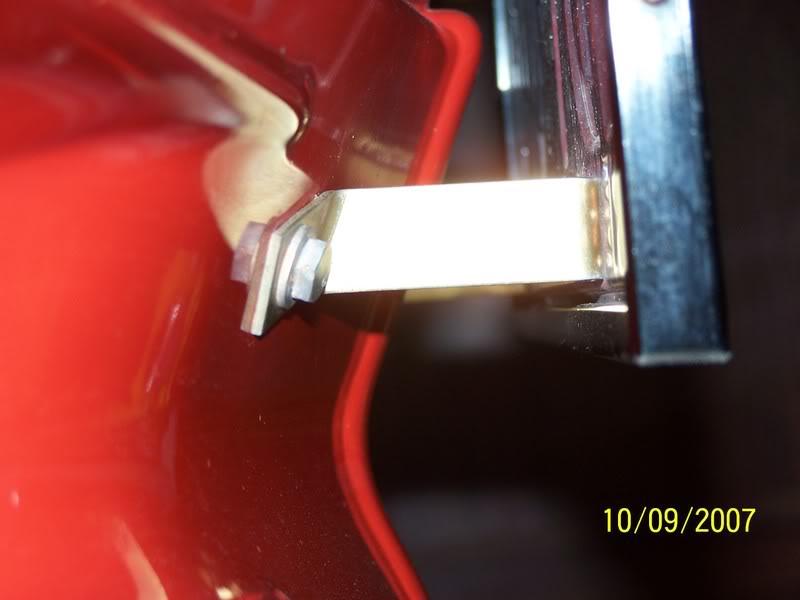

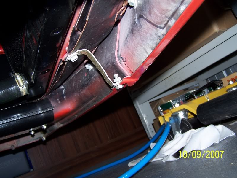

Pictures by RedA9x from this thread. You can see the number plate tabs. The Wilsons spoiler I bought came with the number plate bracket. I removed the number plate tabs for a better fit.
http://www.gmh-toran...post__p__220293

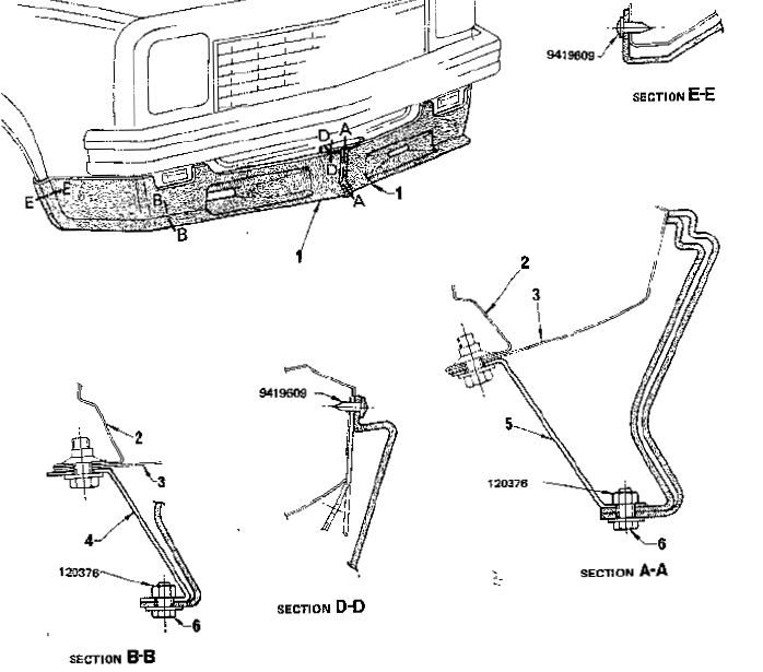

Picture from parts manual looks to show number plate tabs bent back in section D-D.
