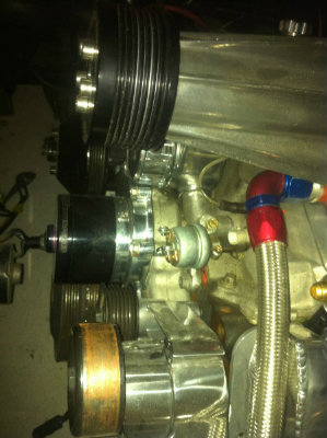

Do meziere do a pump to suit? I have a meziere on mine and it's a bit thinner than the cvr pump u have pictured

not sure, ive never heard of them. I'll have a look tonight. Im going to try scallop the rear of the valance a few inches to fit a 16 inch fan, its the only other way i think it can be done. I rang the engine builder today and he reccomended keeping the water pump because it pumps more water then davies craig.

Yeah I've heard the inline Davies Craig's arnt much chop. How close is the fan face from the radiator? Could maybe get a cm there by making it sit closer

sorry about the shitty phone pic but this is how close the meziere sits on mine

Between radiator and water pump there is about 3/4 inch gap.
