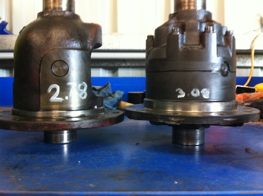

can anyone please post pics of 2.78 and 3.08 large salisbury lsd centre
i know they are different but i don't know what to look for
thanks in advance
looking to change diff ratio from 2.6 to 3.08
and want to make sure i get the correct hemisphere
dave mc

Hope this helps Dave -- can someone please confirm this is correct
https://cache.gmh-to...us/f466d1d5.jpg
#4 76lxhatch
  • 7,218 posts
Posted 03 September 2012 - 01:08 PM
One of them is an LSD but that pic does clearly show the offset difference. 2.6:1 is the same as the 2.78:1 and 4.44:1 is different again
http://i908.photobuc...us/f466d1d5.jpg
thanks for the pics dave

My phone won't let me upload the pics, but the easiest way to I.d them is , on the crown wheel side of the hemisphere near where the crown wheel bolts are, the 2.60 / 2.78 hemi have 10 ( thumb prints) where a 3.08 etc is all flat . If I can upload pic I will.
Swarbs, are you able to take a photo of the numbers on the crown wheel end of the 3.08 centre in the photo and also measure from the bench top to the top of the flange where the crown wheel bolts on on the 3.08 centre also?
If that is indeed a 3.08 centre in your photo and the numbers and measurement matches the LSD centre I have, that Dave is interested in then that should confirm the centre I have is a 3.08 ??? Anyone??

I pinched the photo off the interweb - just done a quick search to try to help Dave out
Pinion part number for 3.08 7449219 Crownwheel 7449220
Sorry can't help with the measurement
^^ Jay maybe ? ^^

I pinched the photo off the interweb - just done a quick search to try to help Dave out Pinion part number for 3.08 7449219 Crownwheel 7449220 Sorry can't help with the measurement ^^ Jay maybe ? ^^
thanks very much dave
i have had john take the cover off to verify the 3.08 crownwheel and pinion
it's just the centre that i am querying
but the photo you posted helps heaps
i'm fairly positive that it's what i need
thanks again
davemc

well after finding a guy to verify the centre that i wanted to buy is in fact a 3.08 lsd
it's been purchased and now in the hands of a very experienced diff builder
to advise me of the condition
as original parts for these are nla and the replacement bits from god knows where
are as i am advised crap!!
i'm looking at having the centre converted to 4 pinion
he will crack test the 3.08 crownwheel and has a lapping
machine if necessary but advises against this option as it tends to remove
some of the case hardness
all new parts are available for this option as well as
oversize cones and this pleases me no end
