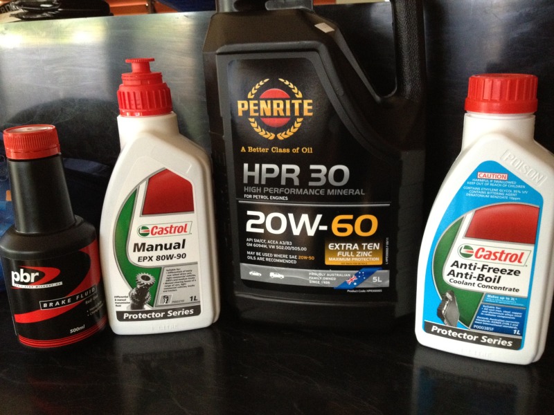

This is what I've ended up with. Not 100% if the coolant is ok?

that coolant should be fine but make sure you have enough . 2 bottles might be better .
There wouldn't be too much difference with the engine coolants would there? Isn't it all basically 100% glycerol?
I have seen and used several cheap aftermarket coolants that stain very badly when they leak (so badly that a wire brush or cutting compond is the only thing to get it off) and thier anti corrosion properties leaves a bit to be desired. I am a huge fan of genuine coolant . I use Holden long life coolant in my Torana and I try to use genuine coolant in customers cars where possible. I have had Toyotas come in with 200 000kms on the clock and still running genuine coolant and the cooling system is like new .

Looks fine to me
Blue brake fluid... you'll need more than that
And not that excited about the coolant... but meh

short on everything but the oil datto....

Yeah I got another 1L bottle of brake fluid. I just thought I got PBR brakes why not use PBR fluid!
I think the better coolant is castrol antifreeze 350. But they were nil stock.
Also have another 1L bottle of gearbox oil.

I prefer to use premixed coolant as the quality of tap water is variable. If you use concentrate then I would use distilled water and make up a couple of litres for top ups.

antifreeze 350 is pretty much the only coolant supplied by castrol
that can be used on v6 commodores as everything else eventually causes problems
i dought you will need the antifreeze side of the equasion where you are
but changeing all fluids regularly should avoid any drama's

Unless the motor is badly worn or you are going racing, a 60 grade oil is going to increase fuel consumption and increase running temps

20W is the cold/winter viscosity.
50/60 is the hot viscosity.
Penrite 20W-60 is recommended for use where SAE 20W-50 is specifided. That is what the "Extra Ten" means.
If you look closely at the bottle you will see it has SAE 20W-50 in yellow writing yet Penrite also state SAE20W-60 in the specification sheet.

It can't be both a 50 and a 60 grade oil. penrite has a history of mistating the specs of its products, typically the oil exceeds the visocity claimed on the label

20W-50 is saying that the oil has the same viscosity a a light 20 oil when measured at the cold temperature.
At the hot temperature the oil has the same viscoisty as a heavy 50 weight oil.

It can't be both a 50 and a 60 grade oil. Penrite has a history of mistating the specs of its products, typically the oil exceeds the viscosity claimed on the label
You missed the bit about the "Extra Ten" marketing. Penrite claim with their oils you can go up 10 in the hot viscosity. Penrite recommend using their 20W-60 in engines designed for 20W-50.
SAE 20W-60
Premium mineral oil formulated for use in conventional and turbocharged engines operating under a high load environment. It provides better oil pressure and consumption control and is recommended where SAE 20W-50 oils were originally required. Not recommended for four stroke motorcycles with wet clutches.
