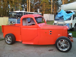

I thought a better put my Ute up. its a 75 Hj, has very minimal rust with only 4 tiny holes in the passenger floor. i bought it off a scrap metal dealer, it will be mostly original once finished apart from being a little lower but not dragging on the ground, hopefully a 5 speed, colour and maybe a set of 12 slotters or something along the same lines. Ive got ss bucket seats for a little bit more comfort. dads a mechanic and had abit to do with the old holdens, which is a massive help, but the rule is I have to do most of the work. its on a tight budget as im 7 months shy of 16. im not the best on computers so i hope the photos work.
Posted ImagePosted ImagePosted ImagePosted Image
and heres a photo of what happens when you let Dad near a mazda Bedford and a vr commodore.
