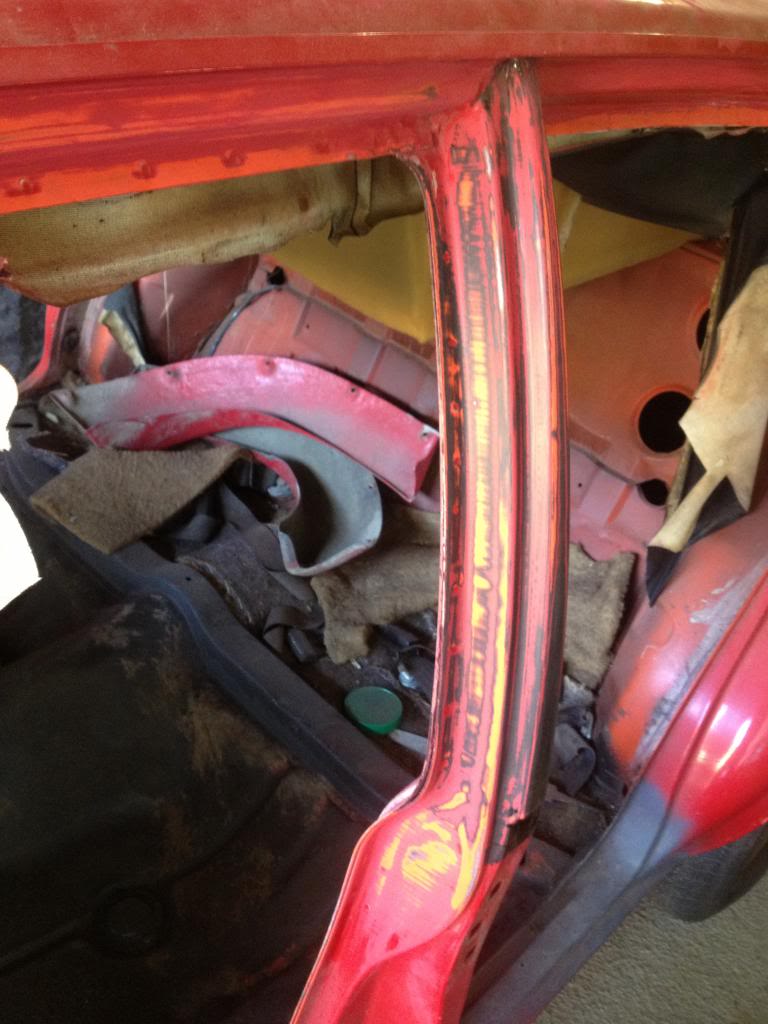

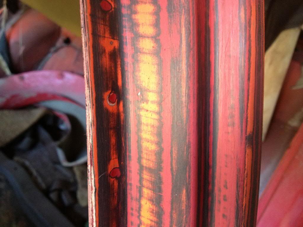

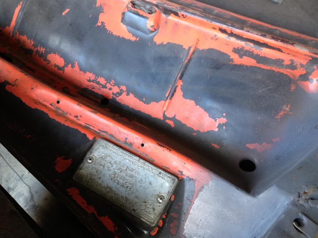

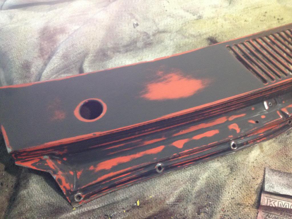

As discussed on here a while ago I have a mandarin red LX which has been painted dark red. Im doing a backyard paintjob and just planning on sanding back the paint a bit then priming/hi fill etc over the top. All rust has been fixed and is in etch primer.
Where the previous paint is good, is it ok to just sand it back a layer or 2 with 80 grit and/or wire brush, then prime/hi fill over the top? Is it best to go back to the mandarin red layer or is it OK, as a mate has suggested; to just use 80 grit to take the gloss off and make a decent key in the paint and spray over that?
I realise that back to metal is best, and thats happened in a few spots, but overall Im not going for a show job, juist a backyard respray back to the original colour.
Heres some pics to illustrate what im talking about.

Thanks Bomber. The paint on there seems very good in most places. The shot of the plenum is an area ive gone over quickly with the wire brush but not the sandpaper yet so still looks flakey. Other areas the paints in good nic so thats good to know. I'll keep flakey in mind as my key word. Pardon the pun.... Cheers.
