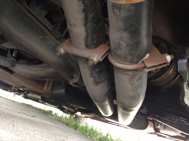

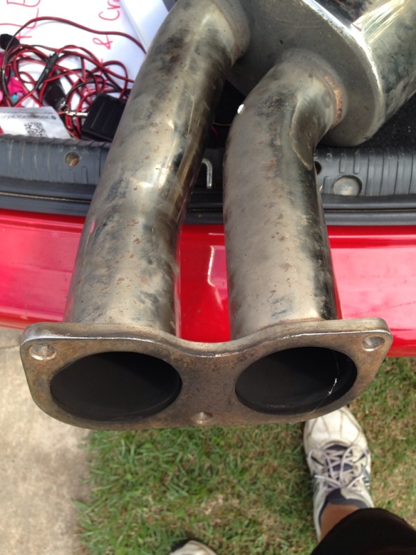

Posted 23 January 2013 - 02:55 PM
This is where is needs to go.
This is the new one.
Just looking at it im seeing that the current system is going to need to be spread apart to meet the new one, as well as have a new flange put on to get it to fit right.
The new muffler is a twin 3" in and out varex electronic mufffler. The varex system works, both valves work and its a neat stainless muffler, but is it gonna be too much work to make it fit for not much gain? Just the ability to quiten it down?
I paid $30 for it with all wiring and remote so its ready to go. Do i just sell it and make a profit or try and make it work. Iv also heard these systems are shit.
#18 orangeLJ
Posted 23 January 2013 - 05:01 PM
Sell i
Sell it. Looks like someone has heated and bent the pipe or it has been banged around a bit. Never been a fan of varex junk tbh.
#19 mitchg
mitchg
    The guy with the Torailer
  • 3,111 posts
  • Name:Mitch
  • Location:Ingleburn, NSW
  • Joined: 19-May 07
Posted 23 January 2013 - 05:24 PM
Thats how they come from varex. Its the rear part for the complete cat back to suit vt-vz. I only payed $30. Someone will want it lol
