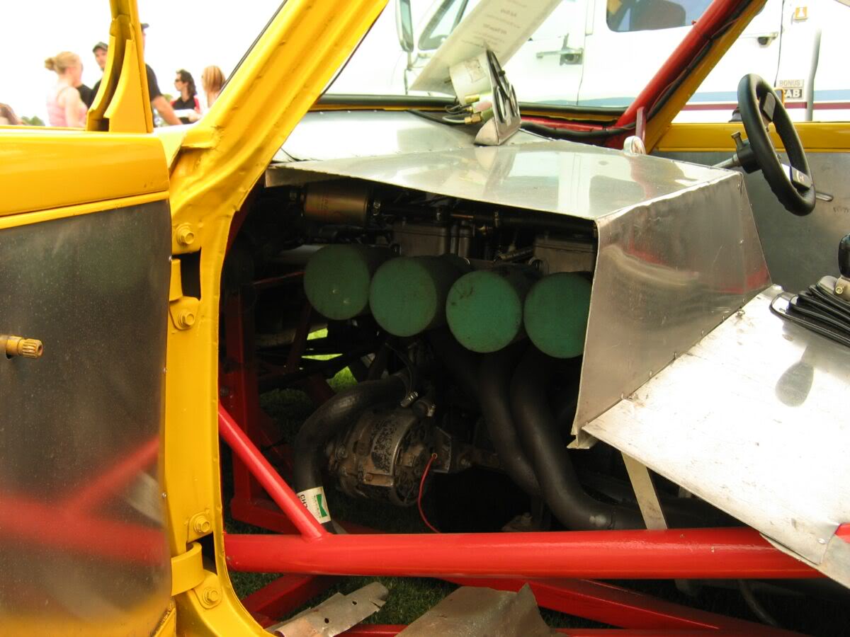

Bit hard to say in my case
With the engine where it is
#6 TerrA LX
Posted 19 June 2006 - 11:01 PM
yeah looks like you hit the wall pretty hard, pushed the motor right back into the cabin. :rockon:

btw dattoman, thats an interesting little beast you have there! A sports sedan perhaps?

#14 dattoman
  • 16,487 posts
Posted 20 June 2006 - 11:13 AM
Correct answer
More pics here Pic page
And more info here My Webpage
