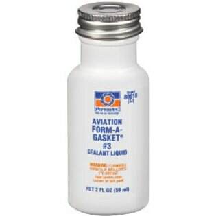

I had thought I had been using the correct methods when it came to sealing surfaces...
I re-fitted my diff centre and used a paper type gasket and #3 sealant, Ive noticed its started to weep again where the carrier meets the housing....
Ive also just noticed a little puddle of oil under the gearbox.... which I just recently put back in after replacing the incorrect input shaft cover...
I cleaned all mating surfaces, fitted new paper type gaskets, applied #3 sealant to both sides of the gasket and torqued all bolts up to GMH specs.
I suspect the gearbox is leaking from the front input shaft cover again, around the drain channel that is designed to drain oil from the input shaft cover back into the gearbox...
This is where it was leaking from previously, and it appeared that the oil had just soaked through the gasket and a sort of capillary action effect took over...?
Should I be binning the gaskets and sealant altogether and use a modern type of silicon sealant with NO gasket??????
I cant believe I have to pull the gearbox and diff centre out again, after using what I believed at the time to be the right method.....
This is the sealant Ive been using with gaskets...

I always use #3 or #4 depending on the application on paper gaskets, have yet to see a leak.

I had the same problem with my banjo diff leaking. Pulled it back out and installed two gaskets. Problem solved. I did use permatex gasket cement on all surfaces but can't remember whether it was the non hardening or hardening type, most likely the #4 hardening cement as it's the only bottle I've had in the cupboard for years.
Did you put thread sealant on the gearbox front cover bolts? Try the #4 cement on the cover gasket.

I used #2 sealant on the bolt threads for the input shaft cover. And #3 on the mating surfaces of the cover itself.

I use #3 also
And don't get leaks where I use it
But realistically its doubtful your diff flange is flat on the housing after all these years
Hence that leak
If in doubt I get a surface linished on a bif flat belt sander .... or use different and extra sealants

Weve always used that sealant in our workshop but on stubborn items the toyoya silicon type sealant seems to be the best i think its called toyota black seal packing on their system

To the original question, if it doesn't seal with Permatex, the mating surfaces are not flat enough.
