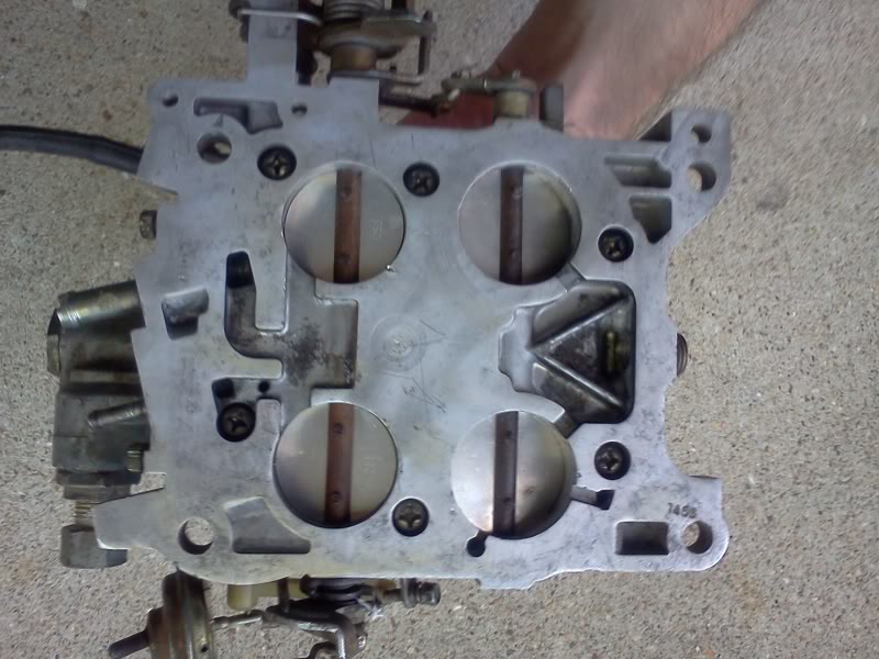

hi , ive recently bought a 4 barrel holden 6 cyl hi-flow manifold [ redline ] & this ugly holley carb is came with it . any idea,s what cfm it might be & what they are generaly used for [ performance or eco ]. NOT that i ever want to use the carb . strange looking carb for a holley . WOIULD the carb be worth rebuilding or is it best thrown under the bench . SORRY if pix are too BIG - im a computer idiot . ANY idea,s on the carb would be appreciated .

Im not 100 % sure but it looks like a 450 4 barrel or could even be a 390 dont quote me on that but i had one that looked like that
Had one on my 308 for economy

Looks like one of the Holley Quadrajet replacement carbs. The 390 I had looked like a 650 vacuum sec.

450 was mechanical secondaries and 465 was vacuum secondaries. Dave I
p.s. this isn't a square bore so I don't know now

Looks like one of those "New Generation" Holleys to me..........There was a few different CFM ratings for this type.............scratch up some numbers off it and post them up Wayne

Found what it looks like but does not say what it is:-
http://www.thirdgen....119-post10.html
p.s. Square bore 650DP on the left so the spread bore on the right must be the next size down a 465?

Its actually an Economaster..came out in 450CFM and 750 CFM sizes to name a few....God its ugly....sort of looks a lot like an Autolite Copy actually!....(sick burp! hahaha)
Good work - so should have 7456 stamped on bottom - bottom right of picture:-

ok , thanks guys . ive stuffed around with a few holleys over the years but cant remember seeing this thing . I will post up the numbers when it gets here . DONTthink it would be worth a reco as it looks past it . yep stretch its one ugly mothe@f%^^^^^ carby .i just wanted the manifold - could not pass it up for the price . lol

Knew it was a 450 as soon as i looked at it actually come to think of it i think there is one on my 308 its been a long time since i looked

Seriously, Stretch is correct, it is a 450 Economaster.
One would have to be desperate to consider spending money on it.

Don't be so quick to throw it away. They really aren't a bad carb.

yep it turned up today - has number 7456 stamped in corner . so its a 450 ecomaster - its allready been thrown under the bench - might clean it & throw it on evilbay the way it is - as is needs kit . see what happens . thanks for all your help .

Yep 450 Holley .Good carby for me ,Great economy on my 350 Chev in my hatch with the spread bore manifold.Just run out of airflow  at about 5000 rpm but that high RPM wasn't why I had  it on my car .I'd give it a kit and someone will buy it for sure ,
