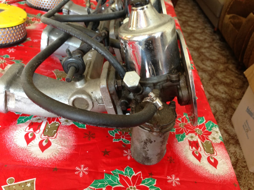

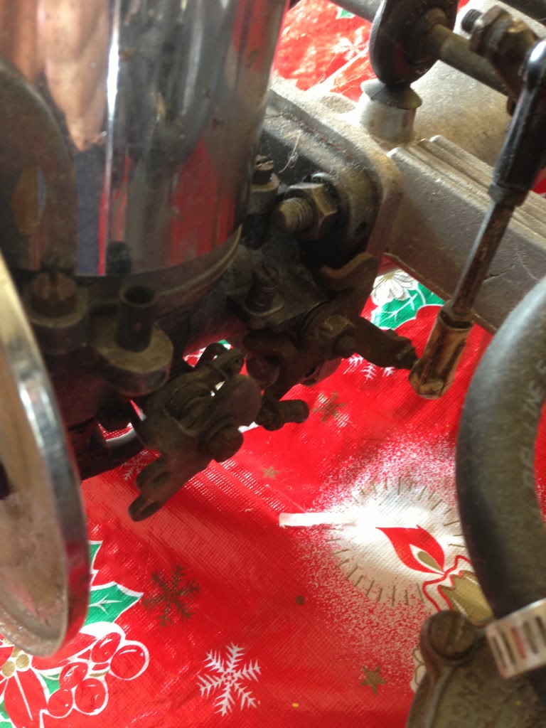

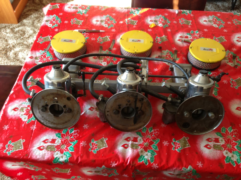

Hi I've got a set of su's and I don't know what size they are. I'm looking at building a mild 202 and I want to know if they'll suit the application I'm going for
(Red 202,blue motor guts,yella terra stage 3head and cam hasn't been decided on yet)
I've got a different set on my partners lj (they have a leaver thing on the bottom(choke?) and mine has it on the side)
Any help will be appreciated cheers
Marking on the carbs I can see
5M00(or OO?)
AUD9
And on the bowl bit AUD 9203
All these numbers match on all 3 carbs
They're on a lynx manifold
What would they be worth?

Look like HI6's from here.

Look like 1 3/4" to me.

HS6's??

Is there any marking so I can tell what size they are? I'm looking at building Johnnos "old school special" so 1 3/4 would be great!

4 mounting studs means they are at least 1 3/4". 1 1/2" and smaller have only 2 mounting studs.

Pull one off the manifold and measure the throat size on the butterfly side.................easy!............They look like 1 3/4" SU's to me

Cheers rodomo. Just found some info on holdenpedia there's a photo of a su with Aud9203 on it but has a tag saying aud503 (1 3/4) but mine has no tag so I'm going with what everyone says and I'm guessing she's a 1 3/4.

They are HS6  SU's 1 3/4"
