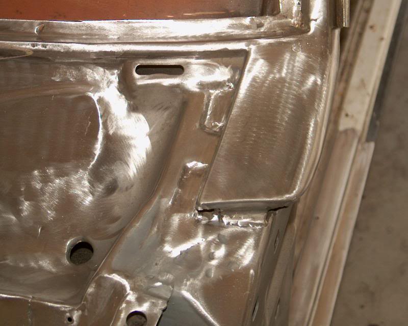

Put a bit more time into the torrie today , just when I thought I was on top of it I saw a pin hole at the bottom of the front pillar I cut it open to find that rust had absolutely caned it , oh well more welding and grinding

Okay so I gained access to the plenum chamber tonight , I was surprised that it only took me an hour . And didn't cause much panel damage at all , can wait to rip into the cancer .

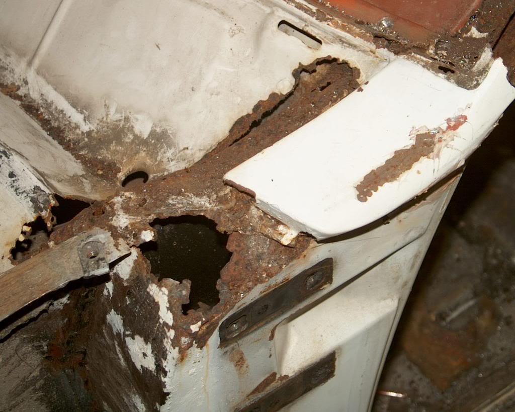

Just spotted your post and thought I might share my "most excellent" experience getting the Plenum Chamber (or what was left of it) out of my Hatch about 6 weeks ago. I bought a spot weld removal tool and it came out relatively easy. Now I need to have it repaired before it gets welded back in.
As you can see from the pics, with the Plenum all the way out I also have really good access under the dash and side kick panels
Did you need to go this far with yours??
I think that my next challenge is to work out how to get it all back together looking as neat as some of "SLAR's" pics on this post

Mine is no where near this bad , worst is around the heater box area , bottom of the pillar , thanks for the pics . Good luck with it
