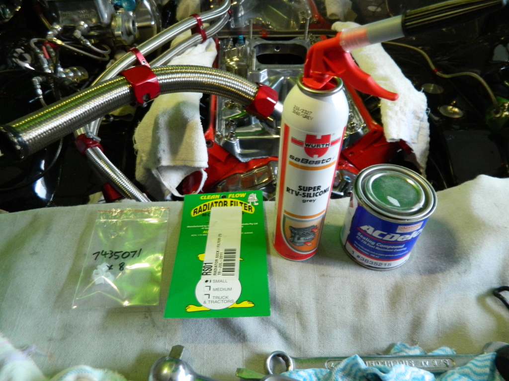

The intake manifold bolts on the BBC go into the water passages in the AFR heads. Do people have a preferred sealant they like for this application?

Gm thread sealer  #3835215

I like using Loctite 567.

yep im with EunUCh GM sealant for me ...the little tin on the right easy to dunk the bolts in

We use loctite 567, and source it from the local bearing suppliers.

I bought my AC Delco sealant from Rares and it was cheaper than elsewhere.
