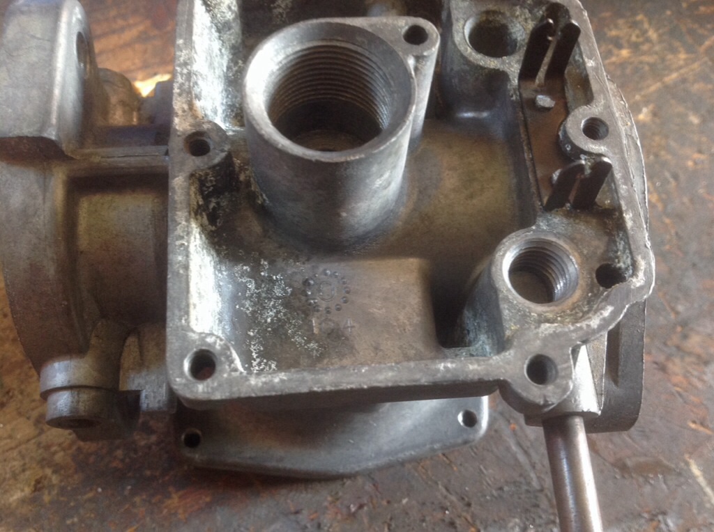

First 2 pics are the 128 104 6E carb
All needles are 6E with the exception of the 128B carb which is 6N
Ok so what are the dates?
This is the second 128 CD150 with no date..

Ken, this one is 1970 vintage. The 0 inside the circle of dots is the year and the dots represent the months of the year.
Is this one a 128, 128A or 128B?
Edited by S pack, 25 July 2014 - 05:58 PM.

Dave that one is the straight 128, the picture below it is the inlet housing of that one, 128
The 2 x 128A and the 128B all have just A104, nothing else, no dots...

here is a lesson in the 150cd carby.
sometimes they at the carby body factory forgot to put down the A-OR-B and sometimes they did not put the A OR B next to the 128. it could be somewhere else on the face of the carby
in this pic of the 1970 cast date the dots are a clock from 1 to 12 you will notice that the big number 8 dot as a small tiny dot inside the clock next to it and then the next small tiny dot is number 11 so that carby would suit any lc xu1 built between the 8th and 11th month of 1970
post-24095-0-98295300-1406264031_zpsc908
you will also notice in that pic that i put a black mark on this part that a xu1 carby should not have but it will have the small bit at the back of the carby,,,that also means that this carby is no good for a xu1
now to the 6E and 6N NEEDLES someone at some stage has changed the 6E needle out of the 128B carby and replaced it with a 6N needle witch where used on the earlier cars
cheers gong

Gong thanks for the lesson and all makes sense. I have a spare 6E needle so I will fit to the 128B carb and put the 6N in the 128 Carby. I will have a closer look for the A or B on the XU1 carb.

First 128 is 10/70 dot code with A104 so im assuming a mov 1970 set of tripples
Photos attached ,
If im wrong please let me know,
