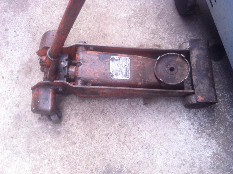

This ones nice, ill take a picture. Has to be 20+ years.
At a time everything had a stamped plated riveted to it, before they started using stickers.

This is the old one.
#13 TerrA LX
Posted 14 August 2014 - 07:34 AM
She looks like a rebuilder.
#14 _judgelj_
_judgelj_
Posted 14 August 2014 - 10:31 AM
It would be nice. It's as impractical as hell because it's so damn heavy but still cool as a second jack.
