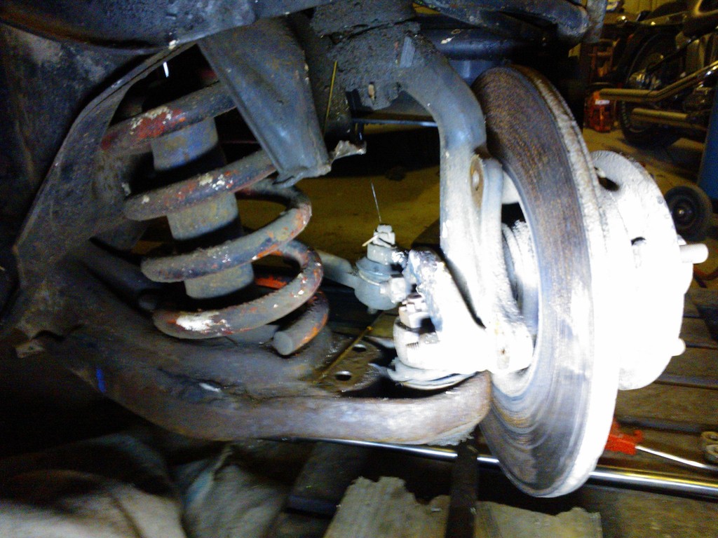

Hi all, I am currently trying to get an LC/LJ back onto the dirt circuit track and have broken a brake line at the caliper, then made a fair mess of trying to remove the seized nut... Long story short im looking for a replacement caliper.
I have no idea what is standard, aftermarket, sitting in the corner of the shed, removed from an old hillman etc on this car, and I cant seem to find much on the Girling calipers.
Will any LC/LJ caliper fit and do the same job? Are these a common caliper amongst any different makes or models from the same vintage?

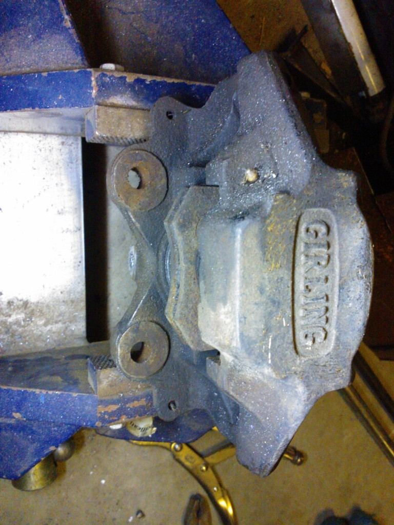

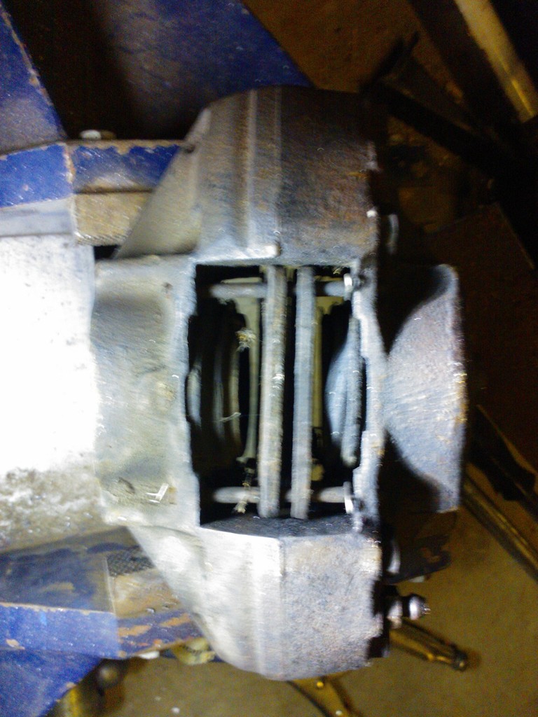

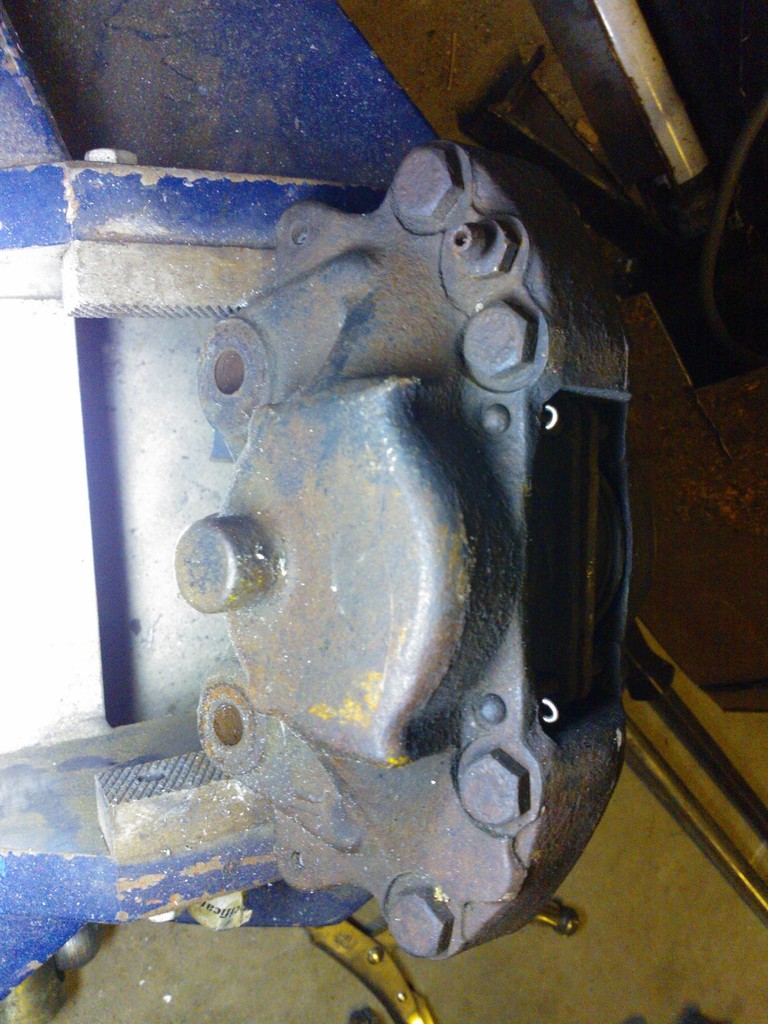

Seeing those pics I'll say HK sorta?
No expert am I.
#7 S pack
  • 15,731 posts
Posted 07 May 2015 - 10:17 PM
If they are off a Holden then I'll also go with the HK model.
Looking at your pics Sam you appear to have STD LC/LJ discs so a Girlock caliper (or pair) from an LC or LJ 6cyl or HK, T, G Holden is what you need.

Never actually seen them marked Girling before
Must have been during the transition when Girlock took over in the mid 60's
