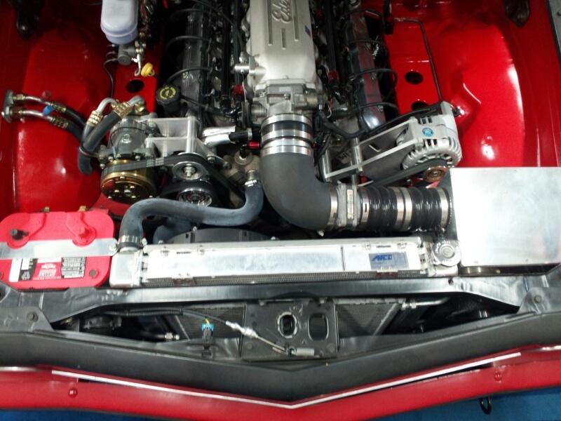

The brackets above with fit an LS engine but it may not fit under the bonnet of a LX Torana.
I originally planned to use a high mount Sanden 508 compressor but I decided I would give the factory variable displacement A/C compressor a go instead as I preferred the low mounting. I have been told by some A/C guys that the factory variable displacement A/C compressor on the LSX motors is not compatible with a TX valve evaporator. Some others have said it may work and others have said it will work.
Dirtbag fitted a factory variable displacement A/C compressor with a TX valve evaporator in his brothers UC hatch. I would be worth sending a PM to see how it worked out.
This is my Sanden high mount setup. It just clears the bonnet with the rear outlet on the compressor. The compressor in the photo has the top outlet back fitted. I am looking to sell the high mount setup with compressor, backets and pulleys on the drivers side of the motor. I am not selling the idler pulleys on the passenger side of the motor.
I purchased the setup about five years ago from hotrodlane.cc
This is the setup on LS1 Hatch from this thread.
