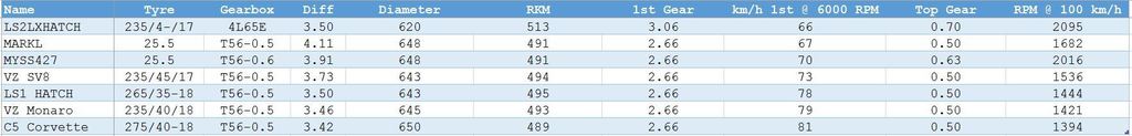

With the .6 overdrive with 3.91 and 25.5inch rolling diameter you can get 1800revs at 100Kph, thats what mine does.

I run a 265/35-18 tire and run a 3.5 diff with my T56...   6th gear is .5 ratio of course...  Even a 3.2 ratio for just a normal driver car would probably work.
Going with a 3.9 or so with a short tire like a 265/50-14 or what ever you had in mind will make 1st gear not even needed really..

Once you have confirmed what ratios are in the T56 use Gearcalc to compare diff ratios.
http://locost7.info/gearcalc.php
Thanks for that! I know there are others but that one is quick and easy to use. I have been undecided about what diff ratio to go with for ages and that one made it super easy.
Taller tyre, VS T56 + 4.11 diff = 1,700rpm at 100km/h which is perfect in my book.

This table will give you a rough idea of how your ratios compare. I guessed you plan to run a 25.5 tyre based on 1700 rpm at 100 km/h.

Depends what you want, and when your cam starts. Mine was a bit low in 6th, didn't really like it unless I was over 110km. I did have 4.11 and now have 4.33 and dint make that much difference, but it raise it about 150rpm at 100 and now feels better. Now at least it doesn't feel like its struggling in 6th. Just got it up on cam.
I'm using around 25" tyres.
Make sure you know for certain what your final ratio is. There is many different T56 boxes

Cheers. The 1st and 6th gear ratios are the same as my understanding. The engine for now will be a fairly stock injected 304, as much as I would like to go nuts with the engine the car is being built as a cruiser more than anything else. 4.11 seems a reasonable compromise for getting off the line a little better and reasonable cruising.

The wiki link below the table lists the ratios and Tag Ids for 39 T56 applications (including Commodore). According to the table there are four different 6th gear ratios and four different 1st gear ratios.
Based on the table I guess MYSS427 has a T56 Chevy Magnum which has a 0.63 top gear.
