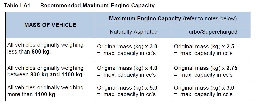

If I use the kerb weight for this particular vehicle (LJ 4 door 4cyl) then its about 880kg. If I use the highest weight in this body style its about 1070kg. The latter will let me use an engine up to about 4.3L, the former only 3.5L.
Can anyone help me with this? I don't want to buy the thing and find I'm seriously limited on new drivetrains.

Posted 22 May 2019 - 11:53 PM
The mass of the vehicle ~ should be based on the heaviest sedan version of the model
Which means all LX Torana, be they Hatch, Sedan, Sunbird or whatever, should be based on the A9X Sedan weight of 1306kg (being the heaviest sedan of the LX model)
So maximum capacity for any LX Torana should be:
5 x 1306kgs = 6530cc (398.485ci) for naturally aspirated; or
5 x 1306kgs = 3918cc (239.091ci) for forced induction.
But, why the hell do they use words like "should" in an official document, is that an absolute rule or not?
Some engineers will quote the table above as gospel, some seem to use it more as a guideline, there have been many examples lately of Supercharged 6.2L LSA engines going into Toranas and early Commodores, which according to that table "should" be impossible to engineer!
The above is courtesy of Bigfella237 - 'Engine Sizes Under NCOP'. Took a bit of finding but that's pretty much my line of thinking. Hell, with a max model weight of 1070kg I'd be sweet for a 253 but as I'm after the V6 I should be fine..
Now to find an engineer.
Cheers - boingk

...and the engineer agrees. Basically it's the letter of the law, as outlaid in the quoted post above.
He did warn that it would greatly simplify the process to use a reputable conversion kit, and to specifically request it come with technical and certification documents from the manufacturer, and obviously the brakes and suspension would need to be upgraded to match the power level, with top-tier factory fitted (eg XU1) components as a minimum.

935 gives 3740cc, that would be within limits for a 3.8L engine.
The 6cyl/4cyl doesn't matter according to the VSB, its the heaviest sedan weight. Conversely, this would work *against* you if you had a heavy coupe or station wagon.
I had a good chat to the engineer, he seemed to think that as long as the brakes, suspension and driveline were up to spec and engine installed with appropriate considerations to emissions, NVH and clearances it would be fine.

The hell with it, have you read the actual document, or spoken to an engineer? I see you have a 4cyl LC, this may be of interest to you. I appreciate it's a guide, but ultimately if you stay within it it's going to be 100% ridgey didge, and that's what matters... to me at least. Here's the relevant part of the document:
2.13.1  Vehicle Mass
The mass of the vehicle referred to in Tables LA1, LA2 and LA3 is the original (unmodified) tare mass of the model vehicle fitted with the largest engine available for the model in Australia but without optional accessories (air conditioning, tow bars etc.). The mass of the vehicle, whether it is a sedan, station wagon, utility, etc., should be based on the heaviest sedan version of the model (not station wagon version) sold in Australia.
Emphasis on "fitted with the largest engine available for the model" and "heaviest sedan version of the model." So be it a 4cyl / 6cyl / 8cyl car, it doesn't matter. All that matters is what that model came with from factory. So HB's are stuck with a tiny weight and engine, LC/LJ about 1070 or so, LH/LX a bit better due to V8 fitments and larger overall weight.
