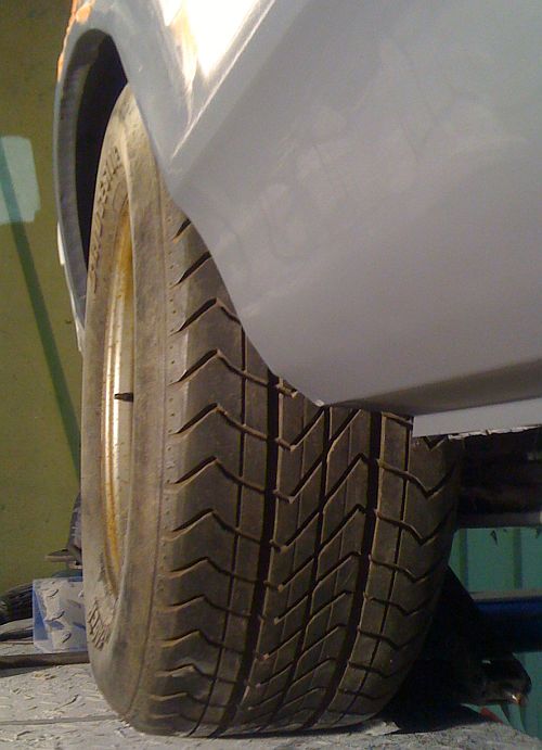

Got two quotes to have diff shortened to fit 8" rims under guards: $800, and $1100, ouch!!. Machining 20mm off inside of rims is not an option, so have decided to stick with 7" rims all round, 225's on rear and 195's on the front as per above. probably looks better anyway as most lc's/lj's have same size wheels all around. Consequently I have 2 x 8" x 15" sprintmaster/gts style rims that have 5/108 stud pattern, zero offset, 4 1/2 backspace for sale at $400 for both, (retail for $345 each). Rims have had tyres fitted but never driven. Includes caps but not wheel nuts (cheap as chips nowadays). Will also post on parts for sale. Happy to swap for a pair of same rims 7" as long as in same or similar knick. Might suit lh/lx with flared guards or maybe Monaro?

 just a bit of information about 8 inch wide rims and tyres under the back of an LC/LJ wheel arch,
 you will need to do a mini tub under the back seat to clear the tyres a little bit like this:-
http://www.gmh-toran...e-2#entry814510
although this one is pinned further back to the chassis rails,
I just opened it from normal like that opening about 2 inches at the front of the arch,
 which also needs the rear seat modified to seat better.
and here is what a 6 1/8" off-set rim can do on a standard banjo housing width:-
http://www.gmh-toran...e-2#entry841368

Thanks for that Dave, handy to know. I might just stick with 7" rims as may have a buyer for 8" rims already, and I'm not really happy with how far the wider rims stick out anyway. Nice car by the way, very jealous!
