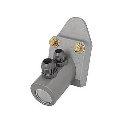

Just to add some more interesting info to this thread, here is another pump that LX406 has mentioned on another forum...
They are from Quick Fuel in USA. US$288 from summit plus around US$50 postage and handling.
Details:
Mechanical fuel pumps for high-horsepower engines.
These Quick Fuel mechanical piston fuel pumps flow an amazing 204 gph. They will operate at a consistent 4 to 50 psi using an aftermarket regulator.
Other features include:
* Compatible with gasoline and alcohol
* Zero drop in fuel pressure throughout the entire rpm operating range
* Variable displacement design easily can accommodate up to 2,000 hp
* No diaphragms, valves, or gaskets
* Maintain fuel pressure with engine shut off
* Hard coated 6061-T6 billet aluminum
* Stainless steel internal components
* 25 lbs. pushrod force
* Available for carbureted and fuel injected applications
* 60 psi unregulated for carbureted applications
* 70 psi unregulated for fuel injected applications
* Weigh only 1.1 lbs.
* Fuel pressure regulator required, sold separately
http://store.summitr....5&autoview=sku
It sounds like a pretty hard-core pump. The fact it will support 2,000 HP makes it sound like overkill for my engine... but it's very interesting, and really, not even that expensive considering!!!!
