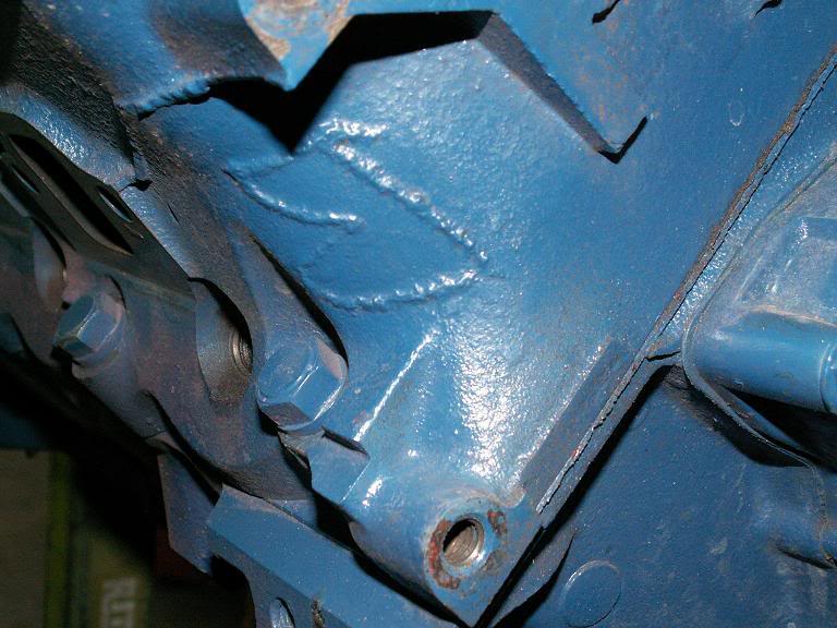

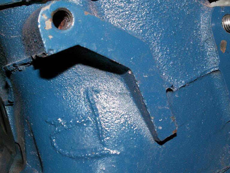

Righto, have had a sticky thru all of that info above and now I want someone to clarify numbers on this engine I have found.
Engine No. VB 50#### (6 digits).
The casting on front of the motor looks sorta like "8 ISLA", where the 8 looks more like a flat screw shape metal dag than a figure as such??
Any help appreciated ...
#4 TerrA LX
Posted 07 July 2007 - 12:56 PM
Hi pallbag, i have engine prefix VB listed as a VK engine=
4.9litre A9L (man) p/n. 92026253 if that helps.
Also cast numbers should read;
day of month= 1 to 31
month of year= A to L (in place of 1 to 12, skip I as not to confuse with number 1)
year= 1 thru to 0 (end of year number)
For example if yours was 15L8 then i would say
15th of december 1978, 1988 or 1998, but VK never produced in any of those years.
other tell tale signs for correct year are CID cast on side, Gear box choice and valley casting etc.

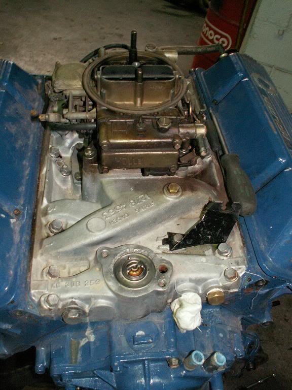

OK, this is what I have ... Can someone translate it to normal language. I am suspecting it is from a VK Brock/HDT of some description, A9L, built 19 Dec 1984.
What does A9L stand for in human terms, similar to L34 I am suspecting?
Stocko manifold I am also presuming ...
And now the heads, correct casting for B Cast heads?
#17 TerrA LX
Posted 16 July 2007 - 08:26 PM
19 of Nov/Dec 84
Heads look the goods, rip the covers off and grab the part no.
Edited by ALX76, 16 July 2007 - 08:27 PM.
#18 TerrA LX
Posted 16 July 2007 - 09:56 PM
Oh A9L is another code same as L34 bar the rollers etc but i believe this motor to be V5H the hot blue version for brock and the chassers but without the H/D rods like A9L/L34.
#19 TerrA LX
Posted 16 July 2007 - 10:56 PM
Just noticed that the manifold has KC cast on the front (top) of it, you might want to budget for a performer for it, from the feedback ive had KC is one of the worst cast and designed duel plane manifolds avliable, even tracking down a good stocker might be the go.
#20 _pallbag_
_pallbag_
Posted 17 July 2007 - 07:04 AM
I have got the Edelbrock Holden Perfomer manifold off the old engine that I was thinking about putting on it but thought I would just see how this one goes for now.
Maybe replace the 465 with the quaddy in a month or so, then if it doesnt perform near the old motor, probably then put another cam in (Crane 286) and then do the intake manifold swap.
I prob shouldn't have started THIS THREAD and asked in here ...
#21 _big_als_army_
_big_als_army_
Posted 17 July 2007 - 11:26 AM
This is a 304 black motor from a VK. With the B cast heads, they are rated at 177kw from the factory. Being a black motor, they have stronger 'x' rods which take larger rod bolts. These are not the same as the 'X' rods from the L34 engines, the x is smaller. I believe they also ran a mild cam, slightly larger than standard to go with the heads and a Brock type manifold which is the same as any black motor one but with the inlet from the carby modified to flow better. The Edelbrock Performer is very similar to the Brock manifold so that will be the go if you already have one.
