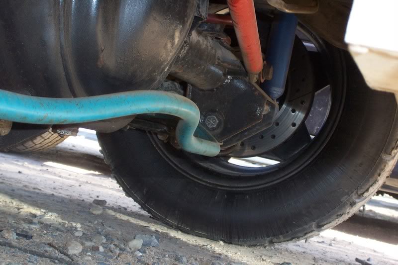

The one pictured would be OK for straight line stuff, but you'll find that it will still move too much for roundy roundy stuff (circuit). Pics below of LXChev366's car. We are doing similar. Long arc, and adjustable mounting height. Still not as good as a .......... brain gone blank, but cheap.
^ from memory connection to the axle was via a 3mm steel plate welded to the back of the trailing arm/shock absorber bracket. EDIT: Ooops it's not, must be another car we looked at!!!
Thanks to Pete in advance.

You want the bar as long as possible and it should be level when vehicle is at usual weight (fuel load). Too short and/or angled and its like a bump steer effect on the rear end as the suspension travels up and down. Ideal solution is a watts linkage but they are more expensive and you may not have the room to fit one (I didnt).

^ thanks Howard, Watt's Link is indeed the term I was looking for. I agree, it's all about geometry, and ideally it should sit parallel with the rear axles. Just a hint, have a look at trying to use the Panhard rod off the VS and later commodore B+W diffs. Seems to be a good fit for the Torrie and nice and long.
