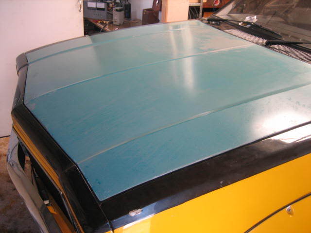

Also do you know if it's legal to use a glass bonnet on the street? It's bloody good an an easy weight saving! The way youve done the bracing i think it would be hard to tell!
Stiffness wise it is a bit flexible compared to a steel bonnet but the next one i make ill do some things a bit differently to make it a bit stiffer.
Legality wise i do believe that you have to get them ADR approved dont quite know not that ill be bothering. Like you say its an easy weight saving and thats what my main goal was to make it look like a original bonnet. if i had more time i would have filled and faired the exposed sections of the inner skin so it was smooth and you didnt see the glass fibres.

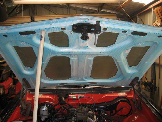

Also, how does/will it be held down in place when closed, same latch/catch system as now ?
Use standard latch system see photos below

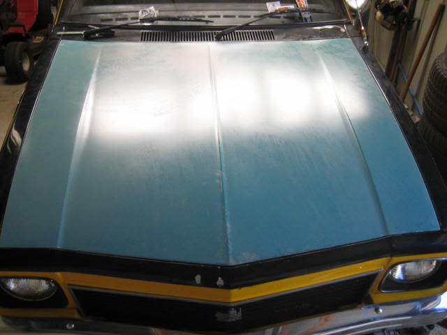

yeah fitted it today the standard springs are just way to strong overkill for a 7kg bonnet will be chasing up some softer ones maybe.
I will be painting my bonnet black(one day). I used a high quality VE resin which has a Heat distortion temperature of 80degress. She'll be right.
What baronvonrot said is true if you want a 2kg bonnet it will cost you shit loads, like anything its getting that last 5% that costs the most. to shave 3-4 kilos of a bonnet like mine is going to cost the big bucks.
Pre Preg would be the go for super lightness, have used this stuff at work really cool stuff. Had to make a Composite Pressure Vessel for the collins submarines. was all made out of prepreg was fun for the first couple days until the novelty wore off.

If the NCOP rules ever come in, they allow fibreglass for non structural panels such as bonnets and bootlids. The fibreglass will need to be min 3mm thick too.
Pre 73 cars you can do the whole single piece fronts because they don't have front impact requirements - don't you just love the logic behind these rules:))
Talking to my engineer, it is a real grey area in QLD with the current regulations.
I am saving my cookies to buy an fibreglass LX bonnet (soon hopefully) so I am interrested in price and more importantly - how straight it is.

I never got a chance hey makka. The outer skin never came out of the mould until it had the ribs glued on. It would have been very flimsy thou, i only did 2 layers of 450csm, (about 1mm thick). So it defantly needed the ribs on it. in terms of weight the inner skin makes up about 1 third of the total weight. It is 2 layers of 300csm.
I think next time ill play with the idea of a vag baged core.(when i get the time)
