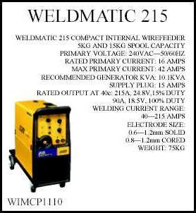

Cheers, I fired off a bunch of e-mails asking the price of the WIA Weldmatic 215 will see what they say...
Everyone reakon this would be a good welder for what I need?

OH just noticed it says "supply plug 15amps"
Does this mean I would need to get a 15amp outlet fitted to my house?
#10 V-SLR5000-P

Posted 11 January 2008 - 10:45 AM
The plug on the welder is for a 15 amp outlet, wide earth pin. This will not fit into a regular 10 amp outlet. My solution was to buy a 15 amp female plug and fit it to a 10 amp extension lead. The cord on the welder is probably too short anyway. Otherwise you can cut down the earth pin to fit into a 10 amp outlet.

Posted 11 January 2008 - 12:08 PM
exactly what he said.
then you'll have no problems at all.

When I was at BOC yesterday they said they only sell BOC machines :( Got a reply from one supplier and was $2310 for a WIA Weldmatic 10 225amp...
Wish I had a trade account somewhere...
Why do they make em with a 15Amp cord if they work fine with 10amp?

Posted 12 January 2008 - 03:22 PM
NO!
There is a reason that the earth pin is bigger, just leave it be.
Just get a sparky in to put in a 15 Amp outlet, that is not protected by a RCD "safety switch"
if you are forking out for a decent welder, surely doing it the right way is not out of reach.
dave

Posted 13 December 2009 - 10:57 AM
Yup, I have a WIA Weldmatic 10mm. Little bro reckons that they are essentially rebadged Lincolns. They said this was the largest that would run on single phase 15 amps, so I'd be checking if that machine isn't a 3 phase machine. Mind you that was 2-3 years ago now. I have 6mm cable running from the switchboard all the way down to my shed, as I new I wanted to run a fairly large welder when we did the extension.
From the manwell....
Connection to Electrical Mains Power
Supply
The Weldmatic 8mm and 10mm are factory
fitted with a mains power supply cable with
moulded 3 pin, 15 Amp, Single Phase plug.
Note: If the Weldmatic 10mm is to be used
at maximum output current and duty cycle,
an appropriate 20 Amp plug should be fitted
by a qualified electrician.
The minimum capacity of the mains wiring
and power outlet supplying a welder
is selected according to the effective
primary current of the equipment. Refer to
‘Specifications’ (Section 3) for the relevant
‘Effective Primary Current’ rating and
recommended mains circuit breaker.
Note : Due to normal variations of sensitivity,
the tripping time of some circuit breakers
may limit the duty cycle available from the
Weldmatic 8mm and 10mm. A higher rated
circuit breaker can be selected, but the mains
wiring capacity must be increased to suit.
Hope this helps.
