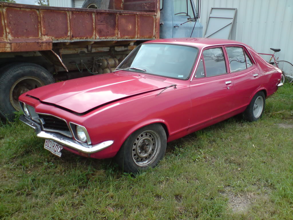

been on here a wile now just thought id throw some pics up of my daily driver. had her for bout three years now
73 lj torana
at a car show i entered it in
me and my mates dato ute ca 18det on a cruise in townsville
when i got it it had a stock 173 red motor and did me for a year untill i decided to build something with a bit more go.

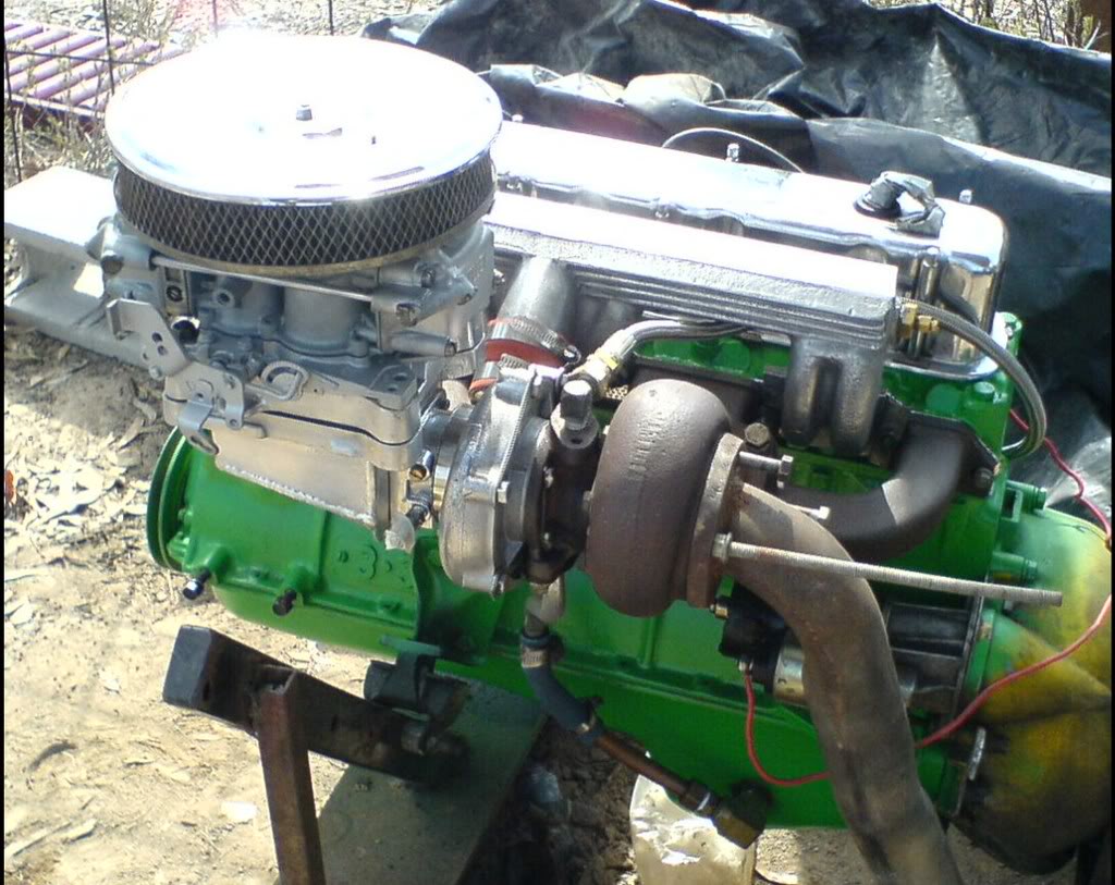

its running a fully rebuilt turboed 202 blue motor to4 strata kit 20psi,turbonetics exturnal waste gate with screemer pipe, 2half exhaust(needs upgrading) ported head, roller rockers, mild cam,650 double pumper holley, locked dizzy,crane fireball elec ignition,water methonol injection, backed by a supra 5 speed.
best et down the strip is 14.0 at 100mph but since changed from 2.7 ratio to 3.08 locked centre and put the 650 on so should run mid to high 13.

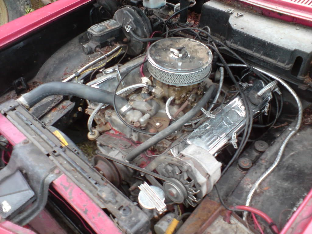

i also just bought an lc 4 door with 308 4 speed chasy kit fitted.not to sure what im doing with it yet dont know wether to get it engineered and regestered fix the bit of rust in it get new locks cause it dident come with keys.also it has hq brakes and stud pattern on the front but standard banjo diff.so do i get a 9 inch made with hq pattern and get hq pattern rims or wat do use recon.or just wait til the 202 expires and swop the v8 into the 2 door.

I notice the oil return line for the turbo enters the sump at a very low point (below oil level ), have you had any problems with turbo bushes or oil leaks with it like that ?

mumstaxi yea engine stand a bit dodgy :D but did the job.havent had any probs with the oil return line.

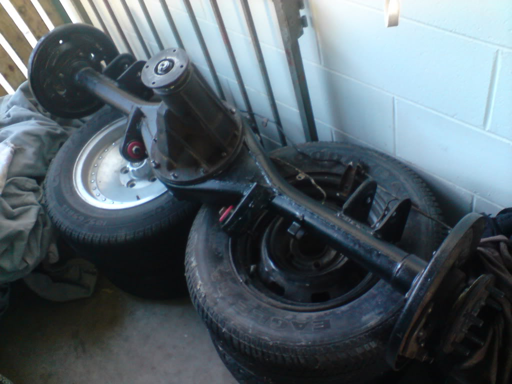

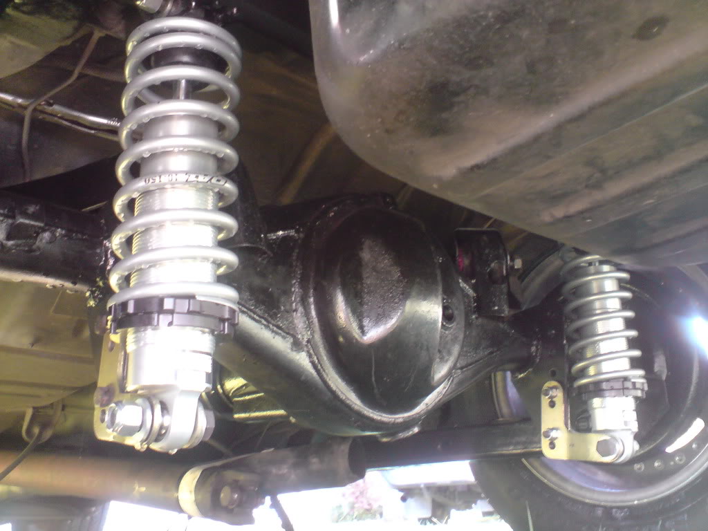

hey guys picked up a hilux diff converted to torana the other day 30 spline, 3.7 full spool and nothaleen bushes all brand new not used for $1000. :spoton: its currently 20mm longer each side than the standard banjo drum to drum, plan is to get it shortened 4" each end (does this sound about right?) and run some convos 15 x 8.5 wide 3-3/8 backspace, square tub it and install coilovers. The hilux diff has 11 inch drum breaks where as the banjo has about a 9 inch drum. Would this be suitable for a 308 conversion or wil i have to convert it to disks some how? I have got hq disks for the front. Also what backspace is corect for the front rims, 4" convos come in 2-5/16 and 1-3/4 backspace which would work best does the hq disks change the ofset at all? :blink:

yea mate thinking about it, want a change, more power :D i came accross this torana^^^^and it was to good to pass up for the price so i either gota do somethin with it or get rid of it so im plannin on swapin the bits ova into my green 1. for now thou im atleast guna put my new diff in and get some new rims to change the look abit. the 202 needs abit of work the turbo oil seal is leakin causing the motor to blow heaps of smoke which will cost $$$$ to rebuild the turbo also needs a rear main seal so gota decide wether i want to spend more money on the six or go v8.
If you end up fixing up the six,i would suggest moving the Turbo oil return to "above" the oil level if you have the motor out.
I suspect the restricted oil return would be the main cause of your Turbo oil seal failure.

that 308 looks awesome in the engine bay...

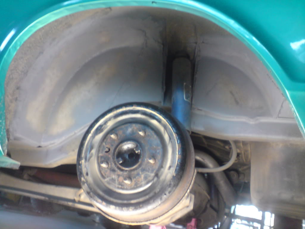

#19 _turbolj_
_turbolj_
Posted 18 May 2009 - 02:22 PM

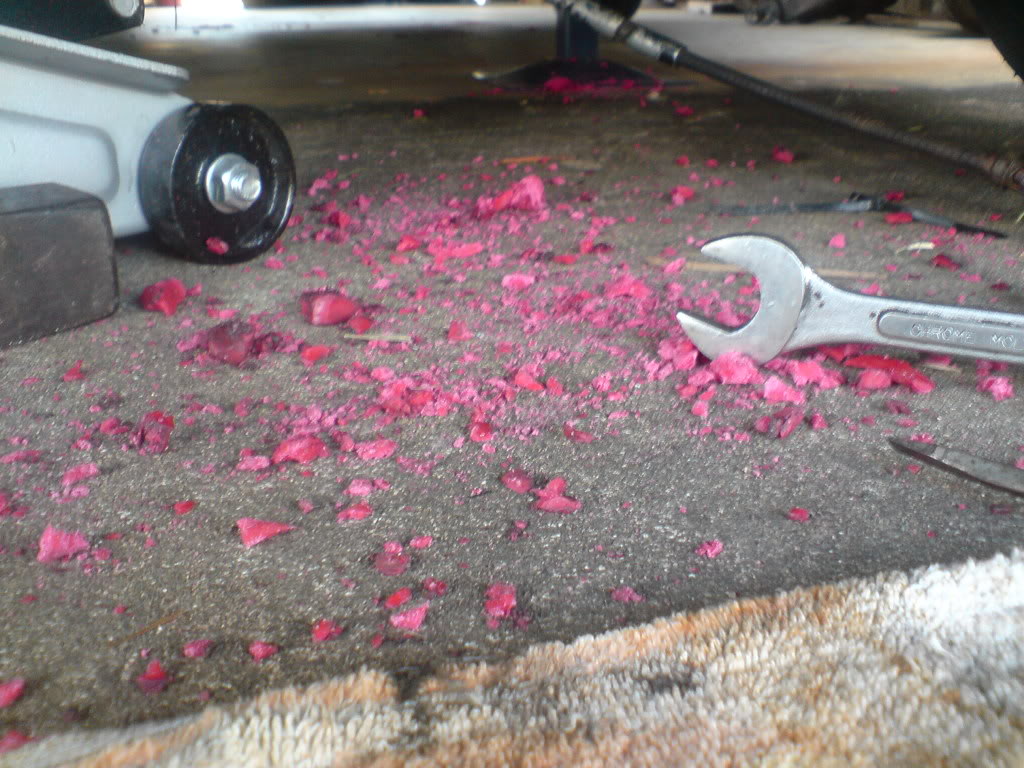

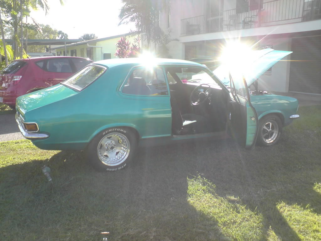

got my diff and wheels under the car but i have noticed the trailing arm and diff bushes are just crumbling to pieces they are red nolathane. has any one ever had this hapen to them? think i mite change them to rubber what do u guys recon is best??

Lookin nice ... is it tubbed?

Posted 18 May 2009 - 05:11 PM

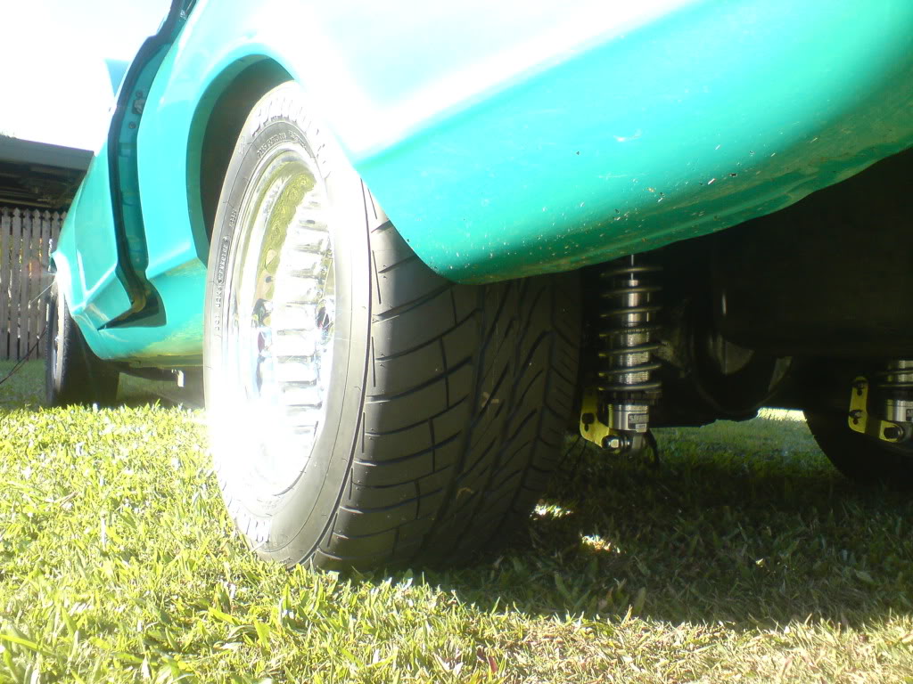

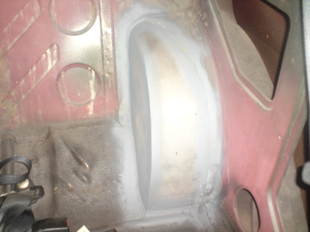

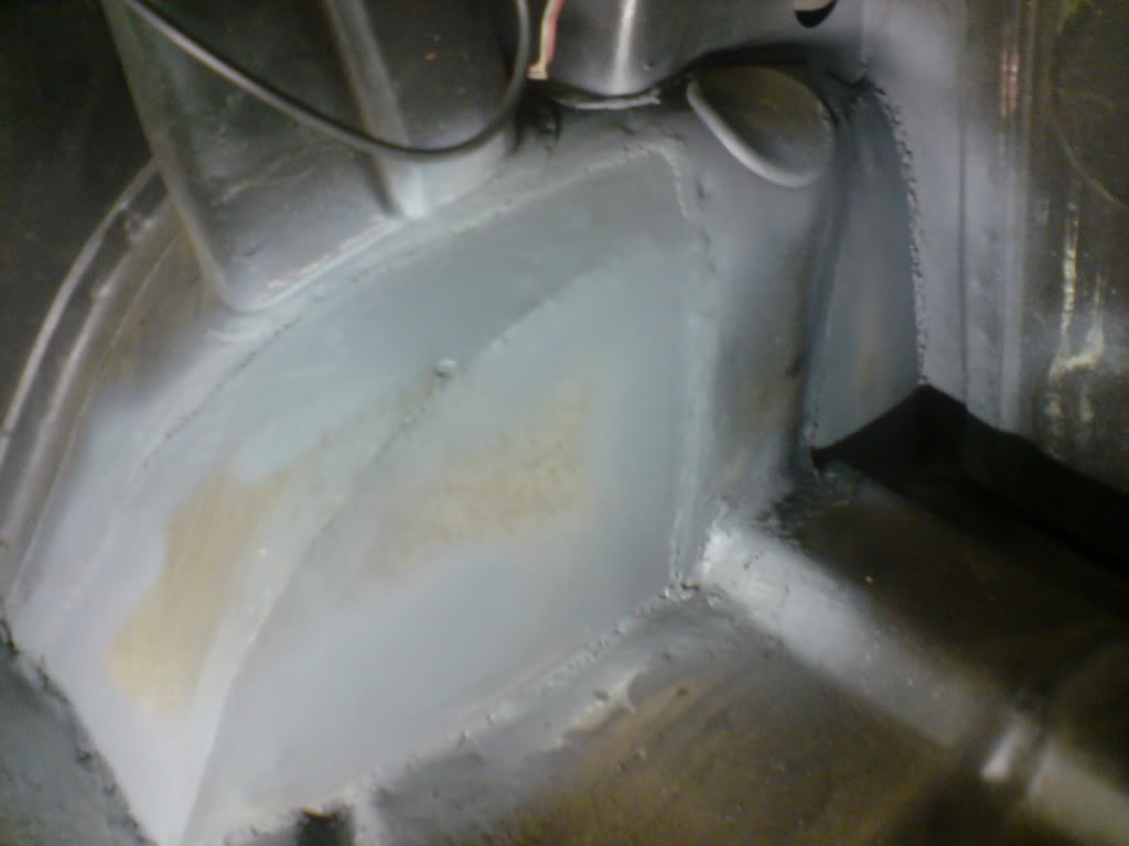

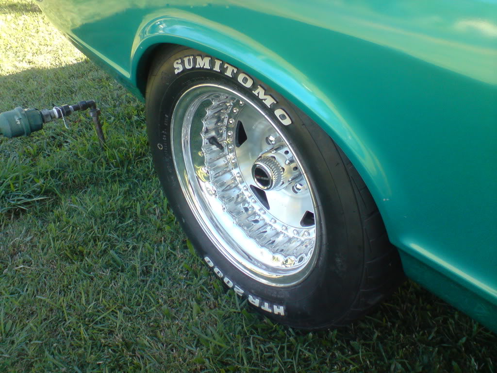

not exactly wat i did is square off the stock wheel tubs to fit the wheels they are 265s :spoton:
and this is what hapened to the bushes think im guna swap them bac to rubber
also lovin your new wheeels they look great! :clap:
#22 gtrboyy
gtrboyy
  • 3,216 posts
  • Location:SYDNEY,NSW
Posted 18 May 2009 - 06:43 PM
Yeah the nolathane do tear apart,usually better to use standard rubber bush in the housing & then some softer grades of bushes in the rear control arms...I used super pro,was a softer grade so the ride wasn't too harsh.
While youre at it,add a plate to brace up the lower arms,reduces them flexing.
What width did the diff get narrowed & what width tyres you using?

Did you weld the mini tubs yourself?

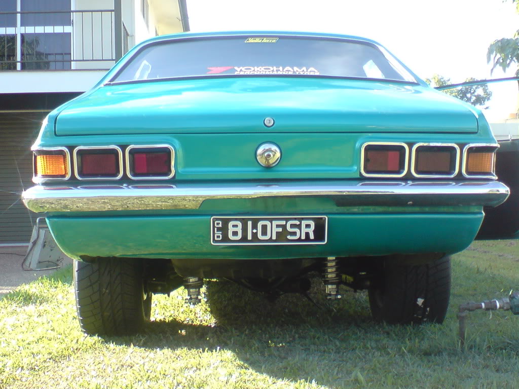

#25 _turbolj_
_turbolj_
Posted 19 May 2009 - 05:52 PM
the diff length is 1175 rim to rim and thats with 8.5 convo pro with 3-3/8 backspace 265 50 15 tyres. and yea ive boxed the rear trailing arms aswell. thanks simon im in condon, a mate an i welded the tubs with his mig, not the best welds just cleaned them up with a grinder and seam sealed them. think im guna hold on to the six for the time being still havent 100% decided wat i wana do with it yet lol.
