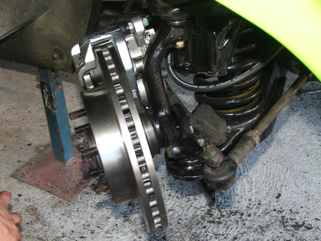

i've used the Hoppers Stoppers kit on my car and my dads too. they are expensive but the kit comes with everything you need-
new callipers,
new rotors,
new hubs and bearings,
new brakelines,
adapter plate for callipers
nuts and bolts required
and most important an engineers report
i opted for the commodore stud pattern and offset to fit commodore wheels on mine.
https://cache.gmh-to...rx/DSCF2017.jpg
https://cache.gmh-to...rx/DSCF2016.jpg
https://cache.gmh-to...rx/DSCF2211.jpg
https://cache.gmh-to...rx/DSCF2071.jpg

if you choose the commodore studd pattern it they give you a different offset to take commodore wheels but other than that it stays the same. have a look at my pics a couple of posts up i have a set of 16" simmons off a commodore on my car, they fit like a glove.
