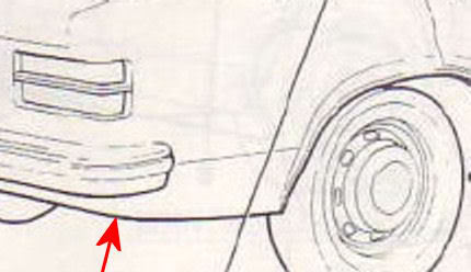

A mate who is a panel beater told me that the rear panel in a LH where it joins the quarter panel see red arrow, you can see the step below the bumper bar where the panels over lap. The LX has this join smoothed over. My LH has this step but I haven't really tested his theory by checking heaps of LH/LXs, I actually forgot he told me about it until Ruts started this thread. I am sure Ruts can confirm or deny with all the Toranas he has access to :D .
