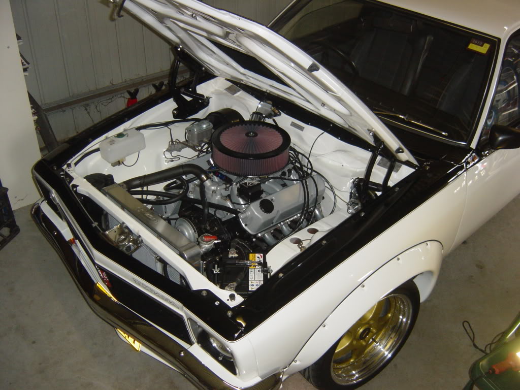

i love my tp duel plane hi rise.the driveabilty and trottle response is really nice.plus it makes very nice torque.
all fits under my scope.i even have a half inch spacer under the carb now.no problems.air cleaner is a kn,14x4 inch with a inch and a quater drop base
this is the height difference between a holden tourquer manifold,and the tp hi rise duel plane
looks good on the motor
and in the car
what are your engine specs?
How much room do you have between your air fiter and top of the scoupe?
How much did you pay for the manifold?
damn! it looks nice !

hi @milco@
not much room left under scope.i wouldnt put a inch spacer on it.i have torana engine mounts to btw
manifold was around $800
rough specs
holley 750 dp
355
very.mild head work,standard vales
11.5 comp
no port matching
full balance
cam=236@50 which doesnt really rev past 6 grand,with a 355.works well with the duel plane.
the motor makes the same amount of torque as horse power,with exelent drive ability on the street
