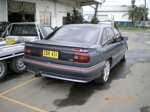

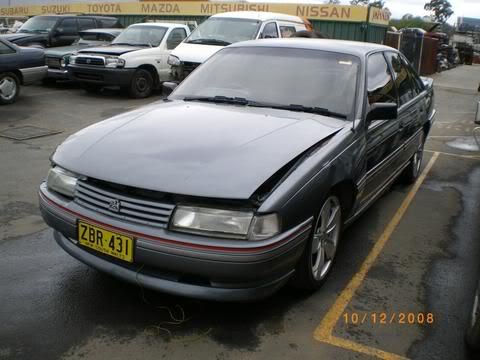

Something doesn't quite match up on the pictures. The date is out by nearlly a year and it looks like it was taken at the old wreckers in montegue street in north gong or it's from farrels in dapro.
Either way it will be a very nice car to drive when it's all said and done.
#35 _nial8r_
_nial8r_
Posted 22 July 2009 - 07:52 PM
Hey Ya Paul :spoton: i picked it up from up in cambletown wreckers, i se what ya mean about the date dude i didnt even notice it my self :huh: but its here now and selling what i can off it ( besides all the running gear of course ) and then it will go to the scrap yard, PM SENT Paul with my address and phone number so you can come and have alok at the mess i have got goin on here LMAO

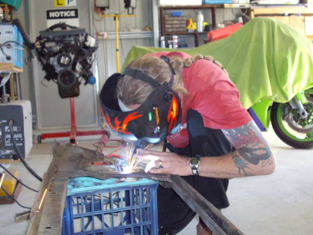

then it came back off again and i started welding it together, the wife snapped this pic of me the sneaky shit she is Posted Image no wonder im blind look how close my head is to the job Posted Image
the new light bucket all welded in and smoother off ready for a quick hit of etch primer before i attack the lower section, im not at all happy with my work but it will have to do untill i come across another support that only needs a touch up here and there Posted Image
ready for the etch primer
and here it is in etch and it still sucks ass Posted Image but hey i guess i shouldnt complain as i might not even have one at all and could be waiting for the next 12 months for a good one lol

You are to hard on yourself that repair looks awsome! and it is going to be behind the nose cone so your not going to see it anyway if it were up to me the support would probably look like swiss cheese i take my hat off to blokes with your skills.
#49 _LH SLR 3300_
_LH SLR 3300_
Posted 01 September 2009 - 06:45 PM
Ah glad to see you've got some progress pics up Lee Posted Image & that motor on the stand in the background looks horn Posted Image Mate, I think you're being a bit too hard on yourself with the quality of your cut & shut on the support panel, it looks fine to me. It looks to have been a real tricky job, but you've done very well. Job well done. We are our own hardest critics though. The paint finish on my engine bay is still playing on my mind. I may be too embarresed to open the bonnet if it ever makes any car shows Posted Image Keep up the good work & keep the pics coming.
Cheers Matt
