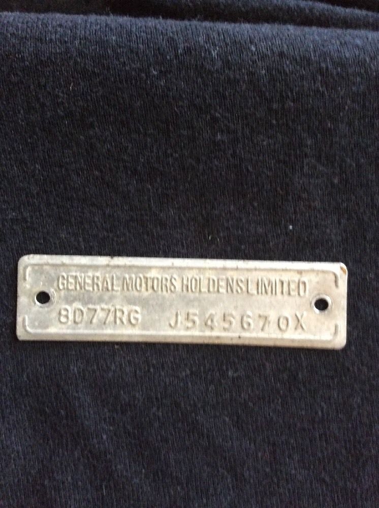

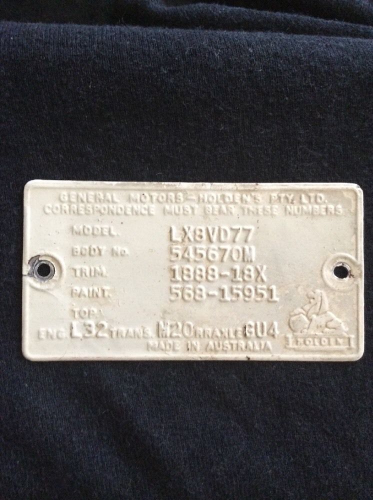

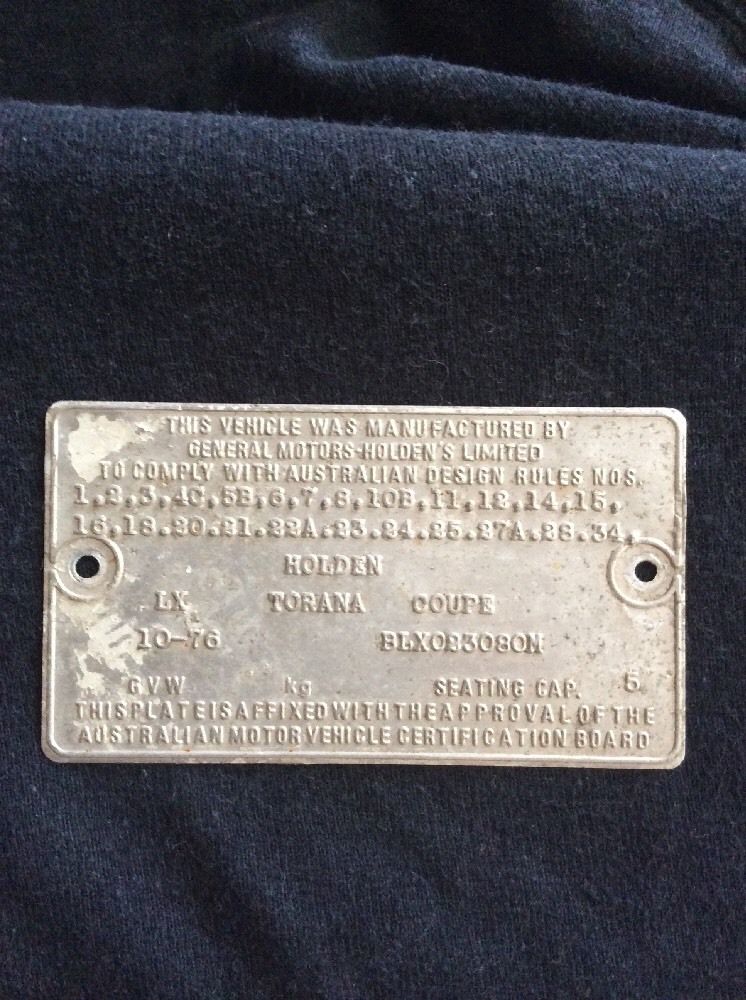

For sale on Ebay 1/2/2015
LX8VD77
545670M
1888-18X
568-15951
L32 M20 GU4
10/76 BLX093080M
8D77RG  J545670X
LX8VD77
545670M
1888-18X
568-15951
L32 M20 GU4
10/76 BLX093080M
8D77RG  J545670X
I believe that should be BLX023080M

You need to actually type out the numbers
From Mick's fb post
Chassis Number: ALX054496M
Build date: 8/76
So really it should be CLX054496M
Next, the VIN Tag and the Body Tag
The Body No: 454887 is actually an LH body number. Production date was 24/10/74 and was 8B69DFJ454887H.
Firstly, any LX built after 6/76 will start with BLX and not ALX
Secondly, that Chassis No 054496M is actually a Sept 1977 built 8H77 Hatchback (body J593200)
There were no M40's built at that time due to A9X production.
The stamped chassis number on the body is so far wrong, it just dumb!
The body number: J454887 is actually an LH body number too.
The Body number, J454887, was originally an LH8VB69. The VIN was 8B69DFJ454887H. Production Date was 24/10/74. Engine # HD16327. The car was 2850, Trimatic, drum brakes, 2.78:1 rear axle.
http://www.gmh-toran...ay/#entry873520
From the pic; VIN 8D77TFJ454887X
s
Edited by StephenSLR, 02 February 2015 - 07:26 AM.
#362 _LHSL308_
_LHSL308_
Posted 02 February 2015 - 07:21 AM
From Mick's fb post
Build date: 8/76
Firstly, any LX built in Aug 76 will start with: BLX
Secondly, that Chassis number is more around Sept 1977. There were no M40's built at that time due to A9X production.
s
Someone's been naughty boy.

Posted 02 February 2015 - 12:52 PM
I had it as a 2 then looked again and thought it was a 9 but thinking about it now it can't be a 9, will have another look, I think a 2 is right for 10/76
Checked again definitely BLX023080M
Edited by tuxedoss, 02 February 2015 - 01:01 PM.
Yep, my 10/76 is within about 780 of that.
Mine's 9/76 and BLX020....

Posted 04 February 2015 - 03:34 PM
They certainly look real enough,but just curious on when they started using "A" after COUPE, and was GMH consistent
with the ADR #'s as they progressed through time...eg..27A 28.29.31.34,even though it seems some numbers were not used
did they actually at least "count up" even though some #'s were not used?,or did they chop and change?,probably info around here
somewhere about that but half the time it's easier to ask again.
#375 yel327
  • 13,783 posts
Posted 04 February 2015 - 03:53 PM
A started once ADR27A came into force, only appears on ADR27A auto cars. ADR's were not numbered or set by GMH, they just complied with teh relevant ones.
