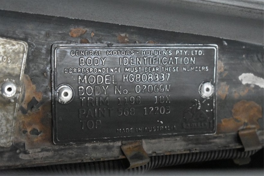

Someone just paid $35k for a guide coated and primed HG Monaro through Grays with a fake body tag. Not that it really matters on a base spec car, but the deception is there.
https://www.graysonl...-coupe?spr=true
Attached File  A605E9CA-6493-4201-AE4C-2CC634B8A582.jpeg   128.65K   12 downloads
Attached File  9836BEF2-DC01-427B-86D0-9E6AF173BB2F.png   540.78K   9 downloads

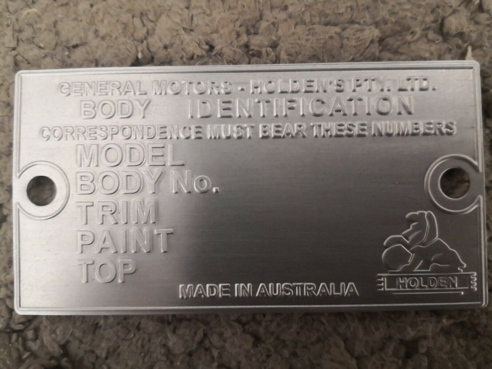

It looks like he used one of these. Perhaps it might have fooled a few more people if he made it look as old as the compliance plate.
Pricks are still selling these on ebay and gumtree in plain sight of the cops. A couple of them are probably even reading this. So instead of bending over backwards to book someone on a quiet country road for speeding by a couple of kilometers an hour, how about finding these bastards and giving them what for.
Attached File  tags.JPG   105.25K   14 downloads
Attached File  Blank HKTG on ebay may 2019 3.JPG   211.81K   5 downloads
02066M

Yel327 how'd you pick the Monaro plates dodginess? What should people look out for?
#789 yel327
  • 13,782 posts
Posted 07 September 2019 - 01:38 PM
Look at the BODY number versus the chassis number, don't need to look any further. People who create fake tags more often than not think they are so smart yet they are really so stupid they outsmart themselves!
Also the model number is incorrect, should be either 80337 for a base model 6 cyl Monaro or 80837 for a 253/308 GTS
That is the first hint, but such mistakes by GMH did happen although uncommon. The body number matching the chassis number is the big red flag.

#795 S pack
  • 15,760 posts
Posted 08 September 2019 - 08:02 AM
Definitely not of the same manufacture.
#796 Shiney005
  • 9,814 posts
Posted 08 September 2019 - 10:05 AM
Yeah, I see it now they are side by side.
