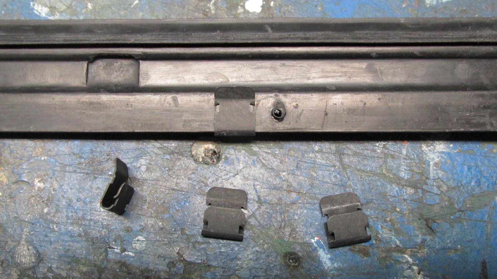

Also having huge dramas with fitting external doorstrips to LJ coupe windows, do I just chuck clips in bin and use sixaflex like john mentioned above? Just thought I'd check before racing down to bunnings tmrw, also is this sikaflex to get?  (Sika 290ml Black Sikaflex-111 Stick and Seal Construction Adhesive)
Cheers in advance paul.

never going to work if you are trying to fit the clips like you have this one shown on the weather strip.
The longest leg of the clip goes on the other side of the weather strip, facing the window.

Marty, Dave, thanks for that, really appreciate it. Dave: I agree, this is what rares supplied in packaging with weatherstrip and are as useless as ashtray on a motorbike.

No i tried installing them the correct way and simply pushed it on this way for photo. The bottom of "U" shape in clip is not wide enough for weatherstrip and metal strip on door, barely wide enough for strip alone. Could easily make my own clips up i suppose but might be easier to stick on with Sikaflex. Why is polyurethane important, is that for flexibilty/paintable/easy to remove? Now if only i was allowed to leave the house, might be a job that has to wait after house arrest in melb finishes in a few weeks. :<_<:

OK, did you make up and use the clip installing tool that GMH recommend using. I found it was pretty much impossible to install the clips without it.

Attached File  2dr belt weatherstrip.JPG   248.17K   11 downloads

weatherstrip dummied up on a HB door skin. The strip is not sitting down as far as it should and the weatherstrip should not protrude down past the metal flange it mates to when it is correctly positionedAttached File  P1040139 01.jpg   214.9K   7 downloads.

I bent this up out of a piece of aluminium.
Using the right sort of clips for the job will make it easier.
Have successfully done 3 cars using this tool and clips without the need of any type of adhesive.
