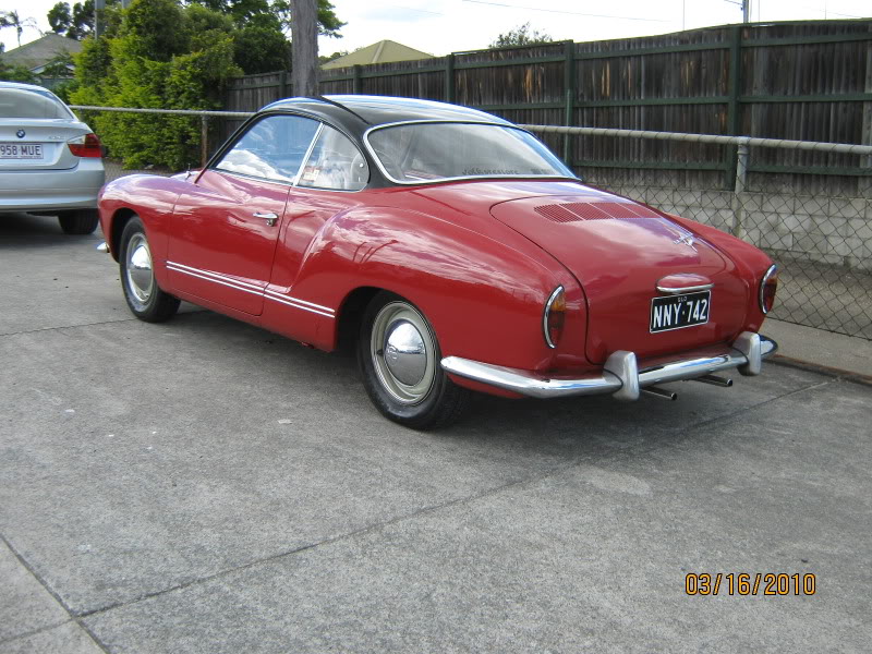

#37 _Pete_
_Pete_
Posted 05 July 2010 - 08:33 PM
I'm gonna weigh in on this one.........
If the obvious solution of your air supply setup and an adequate wax and grease procedure still isnt giving you satisfactory results then there is few other possible scenarios/solutions.
Try doing a Water Wipe procedure before you Wax and Grease. Use two rags the same way as you prepsol but use one damp with water and the other dry. Exact same technique as wax'n'grease. This will pick up any possible contaminants that wax and grease won't. After you have done this then go with your wax and grease procedure.
When you do Wax'n'Grease always make sure you don't let the solvent air dry on the panel, Wax'n'Grease remover works by floating contaminants up off the surface and then your dry cloth is what removes them.
Now this is what I think your real problem is and some folks will think I'm nuts.........
I will bet it's your technique, now here me out because I've seen it happen and still see it happen day in day out by experienced painters.
As you've noticed it's occurring when your spraying solid colours and your really going for a nice finish. There is nothing wrong with your gun technique but there is a step you should be taking to avoid this issue.
After you've cleaned down your job, tack ragged etc and are ready to spray.
Spray a light fast "Tack" coat over your panel, let it set-up a little but not the usual flash off time and then hit it again with your usual wet coat. Let it flash off properly and then apply your 2nd coat. Your "fisheye" problem shouldn't occur and you will have your nice finish you've been chasing.
And to prove I'm not making it up here's proof of this technique......Not one bit of seperation (fisheye) and all off the gun no buffing, done for a very fussy customer.

#39 _Pete_
_Pete_
Posted 05 July 2010 - 08:49 PM
nice!!!!! thats a karmen ghia right?
Yes indeed, I've never really been a Volks guy but this car opened my eyes with its colour/trim combo
