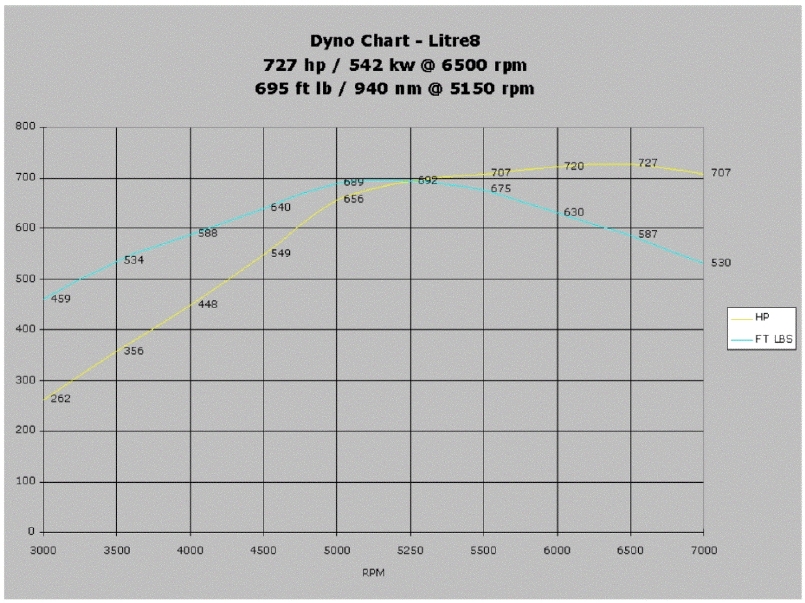

#23 ls2lxhatch
  • 5,332 posts
Posted 24 September 2010 - 11:03 PM
You would definitely have to be happy producing just under twice the torque of Litre8. Please tell me more about this stock boosted engine.
#24 _Bomber Watson_
Posted 24 September 2010 - 11:35 PM
304, Come TB mani, Vortec blower, Haltec.
L8 is NA.
#25 ls2lxhatch
  • 5,332 posts
Posted 24 September 2010 - 11:58 PM
CAPA VE Ute Vortec 409 ci.
The engine was stroked to 409 cubic inches, with a one off crank, rods and pistons installed to ensure the engine could withstand over 20psi of boost at 7200rpm. A Custom Camshaft and Ported Big Valve Heads were also used in the build. A custom supercharger kit was developed to allow a V7 YSi Supercharger to be driven off the crank with a 50mm gilmer pulley system. The supercharger kit install includes larger 3.5" pipework and a Custom 200mm thick intercooler with Mondo Bypass Valve mounted behind the front bumper. Exhaust Gasses leave the engine via CAPA 1 7/8" Tri-Y Extractors and a Twin 3" Exhaust.
The dyno sheet does not show the torque or rpm but if you use 7200 rpm then the torque works out at 675 ft-lbs.
