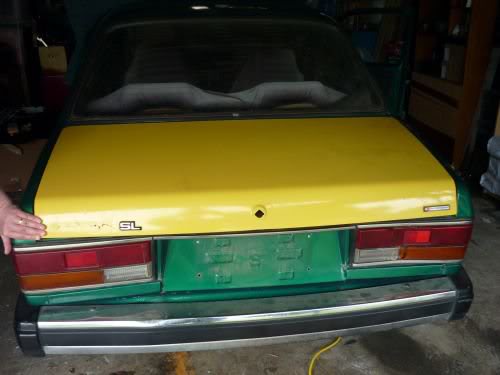

I picked up this TE Gemini SL/X for $300 on Ebay. It had been hit on top of the bootlid from behind by a raised 4x4 and had a little bit of damage to that area. Was otherwise a runner and the seller was hoping to get shitloads more cash for it. Had the Trimatic tunnel which suited my future needs/ideas.
The plan is to put it together with a lot of weight reduction and a 202 Holden straight six for drag racing and burnouts. A bit of a fun car really and something to use as a way of teaching my kids how to work on cars - sure beats playing with dolls.

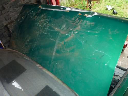

The damage to the top of the bootlid.
Replacement bootlid.

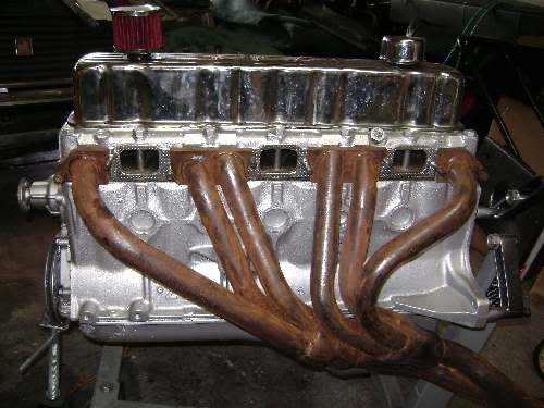

Dummy fitting a 202 with my head, pipes and manifold.

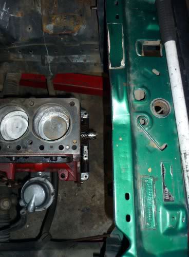

Not a lot of room for a radiator. Tossed up over this whether to use methanol, thus eliminating the need for water pump, thermostat and radiator. Might play around with fitting a radiator in front of the support panel intercooler style.
Plenty of sump clearance with the HZ unit. Tried a HG sump earlier and it didn't clear the steering rack.
Plenty of clearance for the pipes, although the G161 engine mounts will be disappeared.
Pipe clearance here too.

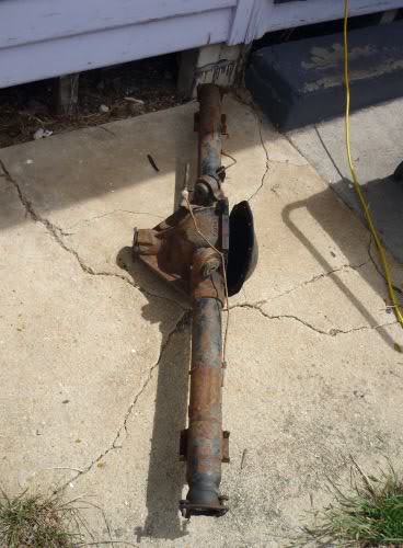

One tonner diff I picked up for free from a speedway racer, who only wanted the 3.55 centre and axles. Looking for a 3.9 or 4.44 centre for it when the time arrives. Will obviously be cutting it down.

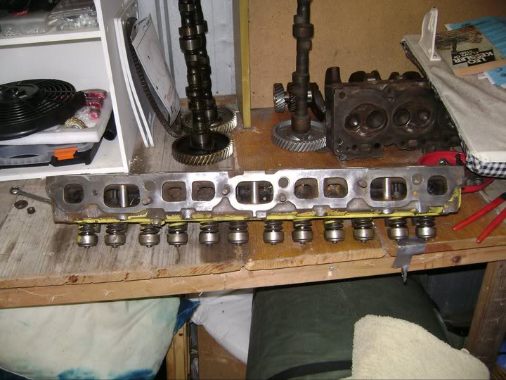

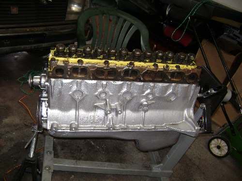

The head I will be using. Not too much or too little shaved off the face. Have seen some people go too far and lose shitloads of power.

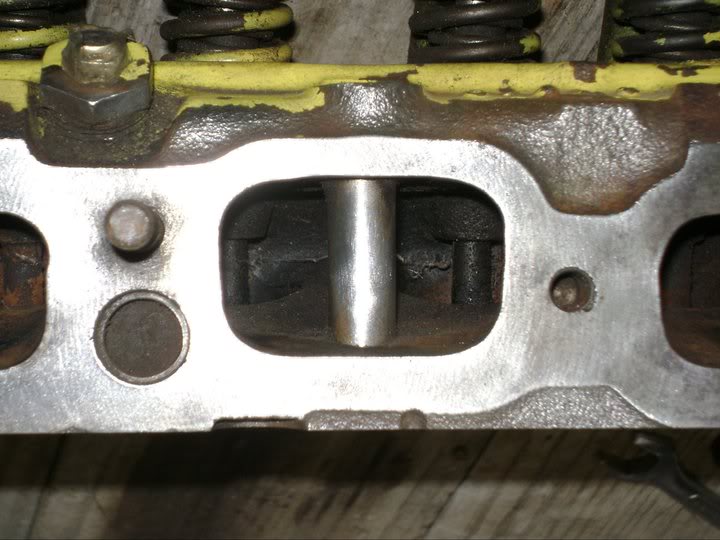

A factory inlet port with the big fat post for the head bolt. These heads were asthmatic on a 149, let alone on a 202 and anything you do will improve the shit out of them.
Hence the removal of the post and replacement with a steel tube. This was done by Yella Terra as it started life as a 161 unit, done to stage 4 specs.
Stock camshaft on the left and the SigErson unit I am using on the right. SigErson cam has a little less lift than the Crow unit I usually use but still has a big lump and a great spread of power delivery.
Roller rockers. Very similar to what is used on the 3.8 Holden V6s.

You could always trim the middle of the radiater support to solve your clearance issues.

Wot179, looks like a good idea. I might start measuring the radiator and support panel up and see what I can come up. I certainly do not want to go to the unneccesary length of cutting out the firewall and setting the engine back, like I've seen someone else do.
