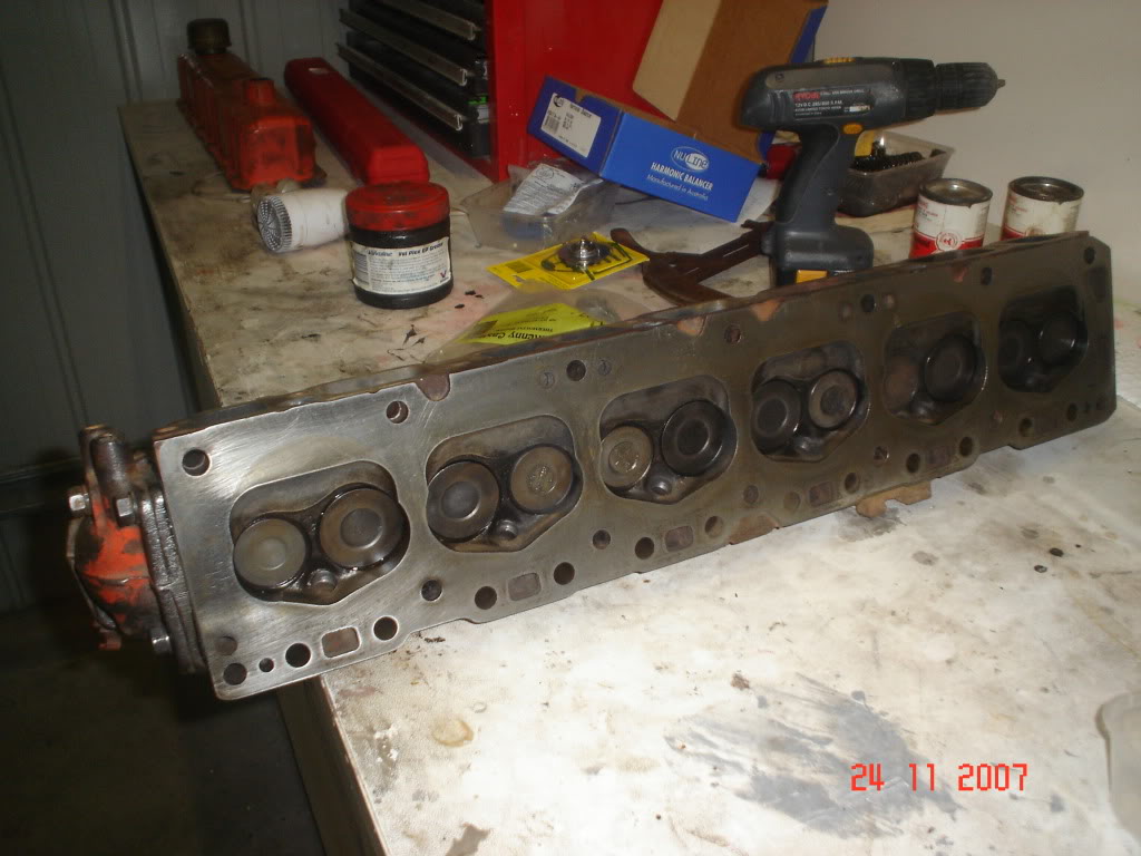

Hi here is a picture of my head on my 202, got the motor off ebay it shows the machining on the small chamber head cheers Glen,

Oh.
My.
God.
Where do i start with this thread??

and wix2250, theyve done that just to drop the CR and reduce squish area in the meantime. the spark plug side needs to be releived/ un shrouded as that is where all the flow is coming from.

holly hell , thats some nice work to the chamber compared to standard how much does it lower the cr by?! did you do it your self?i could do something like that to the 149 could you take even more than that off?

Hi I brought the motor off ebay with the maching already done. I got the motor complete its got a 179 HP block with a 202 red motor crank in it, the head must be a 161 or 149.

How is that nice machine work in the combustion chamber???
Thats appalling...Whoever did that should be shot!!!
Mate if you have read the page by Snarley John and actually absorbed it you would realize similar....

You'll find that Dave Bennett is responsible for the machining....can I get my machining done at your shop?

I have a few YT heads and none have that kinda machining???
At the end of the day this was mass produced shit that performed with the least possible money spent, crap like that high comp proves he was in it for the money not the love....which i have nothing against. Business is business baby.
I dont have a machine shop when it comes to combustion chambers mate, im just a crazy mofo with a die grinder, cc ing equipment, basic knowledge of fluidynamics, half a brain, and im not out to make a quick buck.

Woah never seen it done like that before!

Isnt this a factory chamber???......see chamber pics attatched
http://gallery.oldho...yl+Casting+ids/
part number.....7429477

nope...the casting number is for a kidney shaped 161 head....both those heads have had the yella terra touch

Maybe an early Turbo modification ,done before YT went to the alloy turbo heads .

I've got an alloy turbo head...they are different shapes....the cast and alloy turbo heads were the same shape as each other....available in 69 and 72 cc combustion chambers.
I used to own a yt head with the same shape as the one pictured....until I cracked it.
