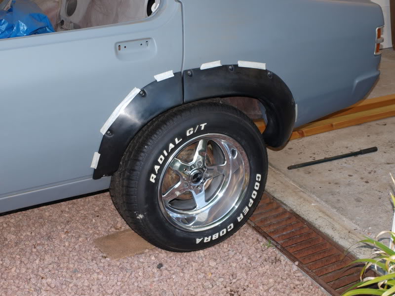

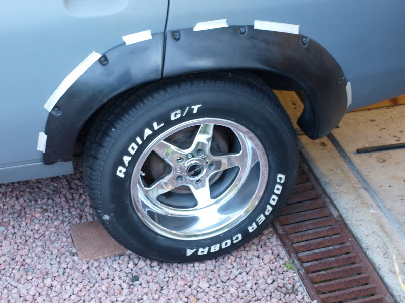

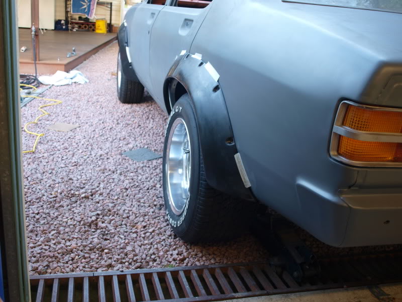

Like these? Front 15 x 8--- 4.5 inch backspace, rear 15 x 10---- 4.5 inch backspace running 215/ 60 front and 265/50 rear, rolling diameter is slightly smaller on the front.
Went 215 's on front simply for clearance issues and steering lightness but the offset fills the guards no worries.

i strongly recommend not to buy these tyres,i was running the 352 yoky,s, was talked into the cooper,fitted them a 265/50/15 they were a good inch narrower,which was yuck,i perrsisted to use them,millage was shit and they wore in middle with only 28psi,on a holden 1 tonner,the 352 wore evenly as did the bridgstone before them.
you can see how narrow gutted they are on the rear of slar,s pictures.
