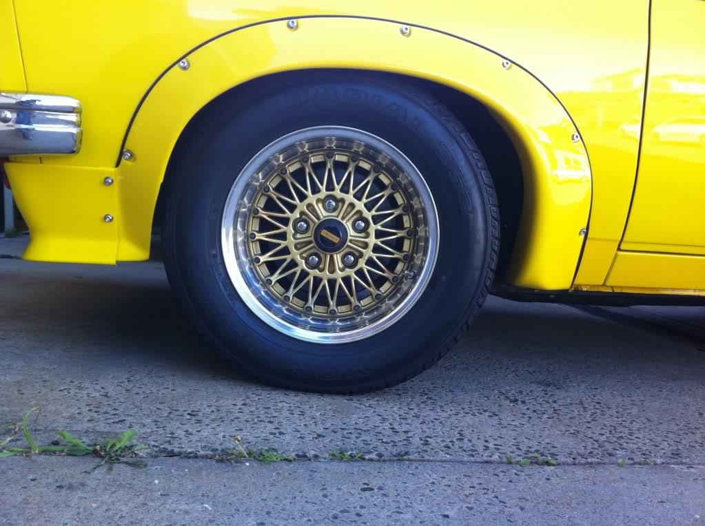

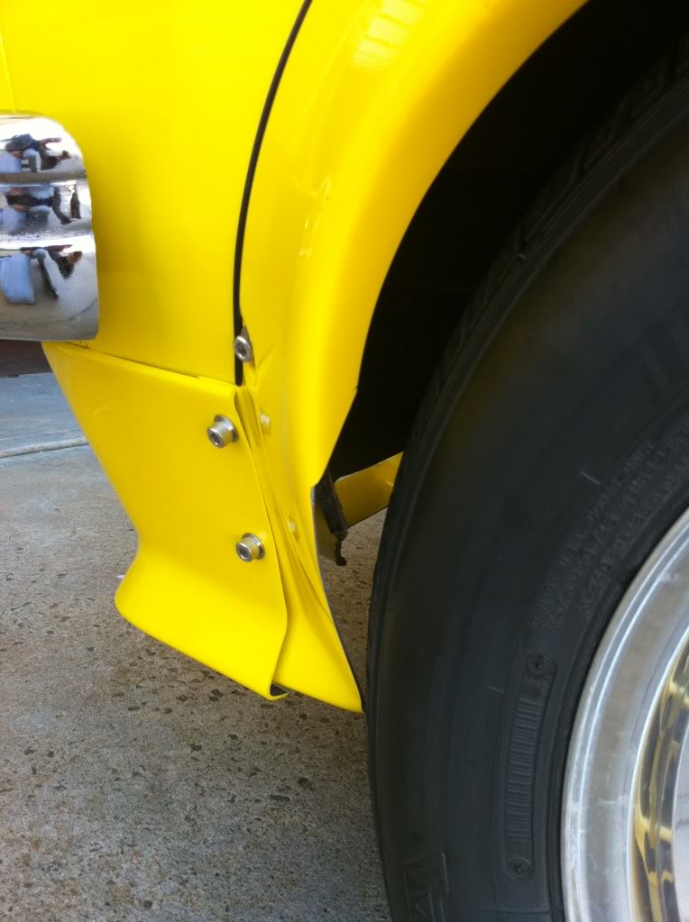

I would have thought that 235/60/15 would be too big for the front
How dothey look and how much modifcation ,if any did you do
Dont waste your time fitting the 235/60 to the front as you wont be able to turn due to sever rubbing.The OD is to big.
I have 235/60/15 on my car. It doesnt have severe rubbing, and not too much modification. I had to trim the inside return part of the lower front of the front flares on both sides.
Thats about it.
Visually I would have preferred 225/60/15, but Yoko do not make that size.
Faliba, I am on the Eastern Beaches in NSW (Coogee/ Bondi) if you would like to see the car, or even try these wheels on your car.

I wouldn't have thought they were 60s from the pics in your sig, any chance of a close up photo or two?

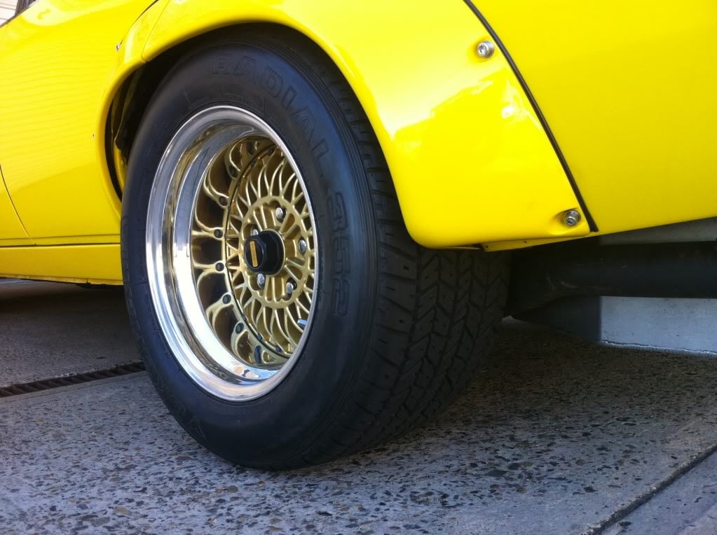

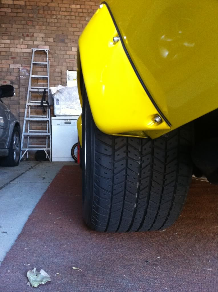

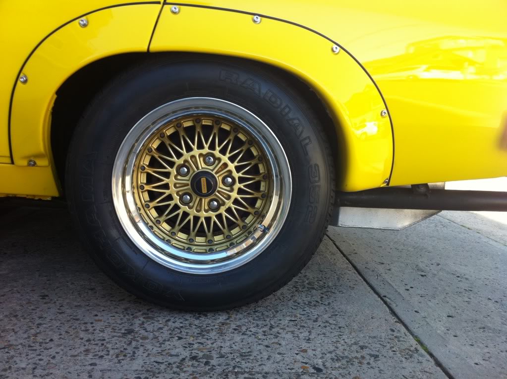

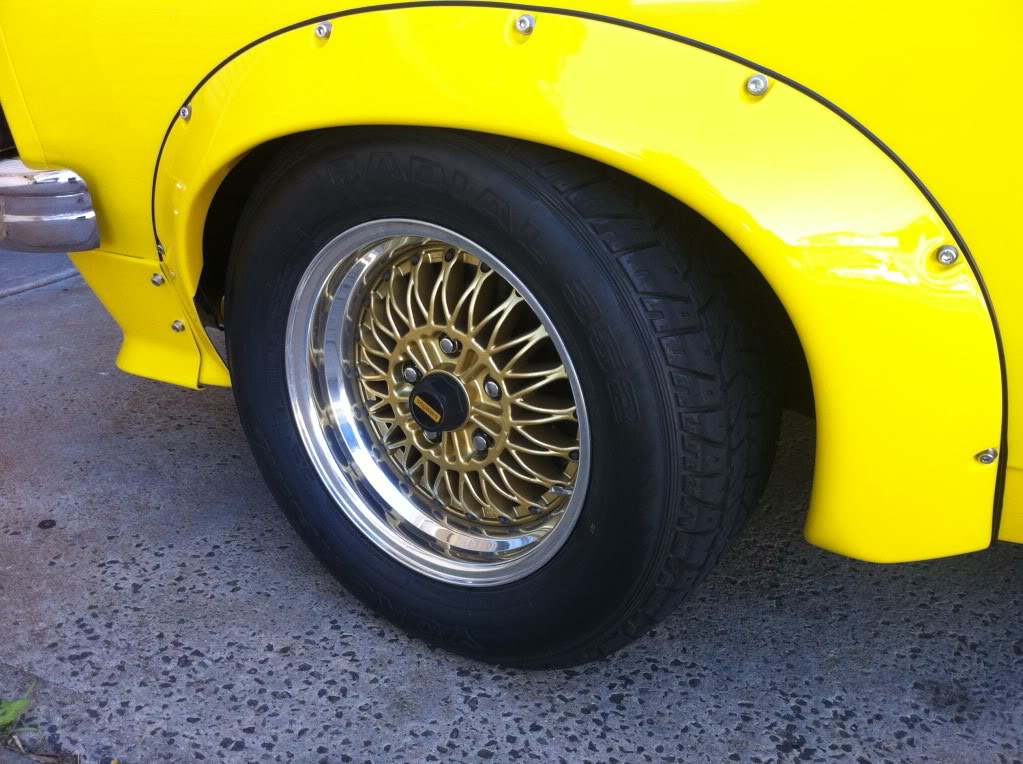

Posted 09 July 2011 - 01:13 PM
Sorry for the delay.... but here are some close up pics
Fronts- YOKO 352's 265/50/15
Rears- YOKO 352's 235/50/15
