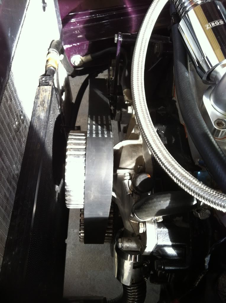

#13 _injlc304_
_injlc304_
Posted 13 December 2011 - 09:01 AM
see how it sits right at the back of the top pully
see how that alternator is on a slight angle facing in ( right to left)
http://s1223.photobucket.com/albums/dd512/mipples/?action=view&current=IMG_0759.mp4
here is a video of it running if the link works. it dosnt really show how much it moves when you rev it but yeah

Posted 13 December 2011 - 09:28 AM
That belt is moving around a lot, but I think you can trace it to the alternator being out of whack.

#15 _injlc304_
_injlc304_
Posted 13 December 2011 - 09:42 AM
was thinking if i can put some packers in behind the bracket at the 2 bolts it should bring the bracket back a round a tad..

Looks like you have the wrong pulley for the water pump.
Chris..it's got to be alignment is your problem..or youre running a "early" water pump Gilmer kit on a late model(long nose) one
#17 _LHSL308_
_LHSL308_
Posted 13 December 2011 - 11:24 AM
I think you got 2 problems there. Firstly obviously the alignment of the alternator then the top pulley, shouldnt be sitting that far out, cant see behind the belt but it looks like that pulley needs to come in around 1/2 an inch or so. Looks good though mate, will be getting a set myself once I source some decent thermo's.

#18 _injlc304_
_injlc304_
Posted 13 December 2011 - 11:48 AM
i've always thought it looked like the pulley or water pump is wrong just by the fact its a fanny hair from the trans cooler. might see how much a new water pump is and see if the pully will fit it?

#19 _Mint_
_Mint_
Posted 13 December 2011 - 05:16 PM
Chris..i reckon you have the correct water pump for that motor(long nose)..so the kit is probably wrong(for early red motor)
the top pulley should sit closer to the pump housing..how ever you may have some success spacing the alternator bracket a little?

#23 ls2lxhatch
  • 5,335 posts
Posted 13 December 2011 - 11:59 PM
Measure the difference between your water pump and the shorter version. If that will bring the water pump pulley back in line with the rest it will look a lot better and will help keep the belt on track. Then you can have another go at shimming the alternator if required.
