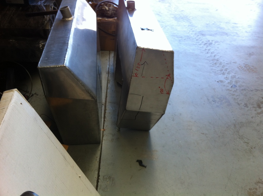

The new tank arrived at the workshop this week. I put the old tank next to it to check the difference in departure angles, looks good to me   :D
As you can see from the markings its lost about 70mm to make it legal.

#111 ls2lxhatch
Posted 31 January 2014 - 07:41 PM
It is a bit strange how low the filler neck is mounted in the tank.  Normally you would have around 10 mm above the neck to reserve air space for expansion like the old tank.
Once the fuel level reaches the top of where the neck meets the tank there is no way for air to escape so you won't be able to use the top 30 mm (guessing from the photo) of the tank unless you have a really good breather system running to higher up on the filler. I can't see any sign of a breather system on the tank.
Edited by ls2lxhatch, 31 January 2014 - 07:42 PM.

Thanks for the input about the tank Ls2lxhatch.
I will be contacting them on Monday before the tank gets polished in case of of any modifications are needed.
