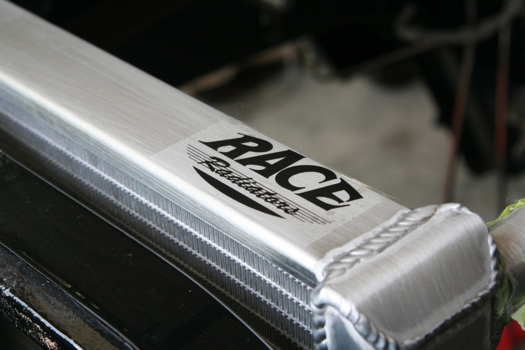

#10 _IFA 355_
_IFA 355_
Posted 13 April 2012 - 02:44 PM
This is a Race Radiator I have in my LJ.

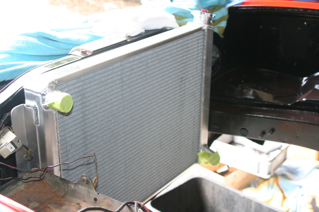

#11 orangeLJ
Posted 20 April 2012 - 12:26 PM
I bought a FENIX radiator earlier in the week, $270 through my pricing.
Looks OK, welds aren't anything overly impressive, but are still presentable.
The biggest issue Ive encountered though is the size. It wont fit between the rails without minor trimming of the tabs, and Im going to need to make some new adapter brackets to use the original bolt locations as the thing is too wide all round.
Would love a PWR one, but the $750 is killing me!

#13 orangeLJ
Posted 25 April 2012 - 06:40 PM
Well I bought the Fenix radiator for my orange torry, but there was no way it was going to fit without hacking out the original mounting points, and to be honest, thats not high on my priority list of things to frOck with/up.
Soooooooo... considering we are heading to wakefield next week in the purple car, I threw it in that today. Have some pictures that I'll hopefully get to put up later, but it required cutting the raised tabs from the firewall, trimming the tabs on the radiator itself so it could sit lower, drilling new holes int he rad support for mounting, slight panel beating of the lower, inner valance to clear the bottom tank and customising a radiator hose to get the top outlet to line up.
With that in mind, Im thinking of going PWR as Chris (WyldLC) has informed me that his fit without any modifications (and it looks awesome)
Might be blowing the $800 after all...
