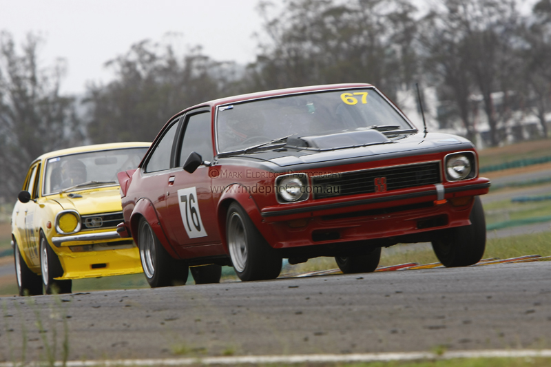

they look good Bomber, fit is fine.
Have a squizz
#17 _Bomber Watson_
Posted 21 April 2012 - 10:58 PM
Bit stretched IMO, how i thought they would look, wouldnt suit my car, but looks fine on yourse.
Have a squizz
PHAWR!!!!!!!!!! That is B E A U T I F U L!!!!!!!
