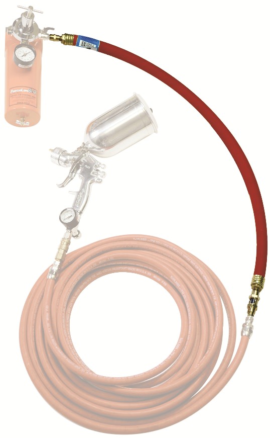

I always use the Devilbiss snake"..I recommend it.. Its not cheap, but moister is the killer.. this takes care of that.. and I also use 2 regulators/water traps.

Whats this snake thing? I've not long painted my little Celica and its full of small humidity blisters. I've taken steps to stop this fr0cken moisture even though I've improved it just can't completly solve it.
G'day Jon,
It's a "Desiccant Snake" or "Disposable, In-Line Desiccant Air Dryer"
See here: http://www.autorefin...cant-snake.aspx
