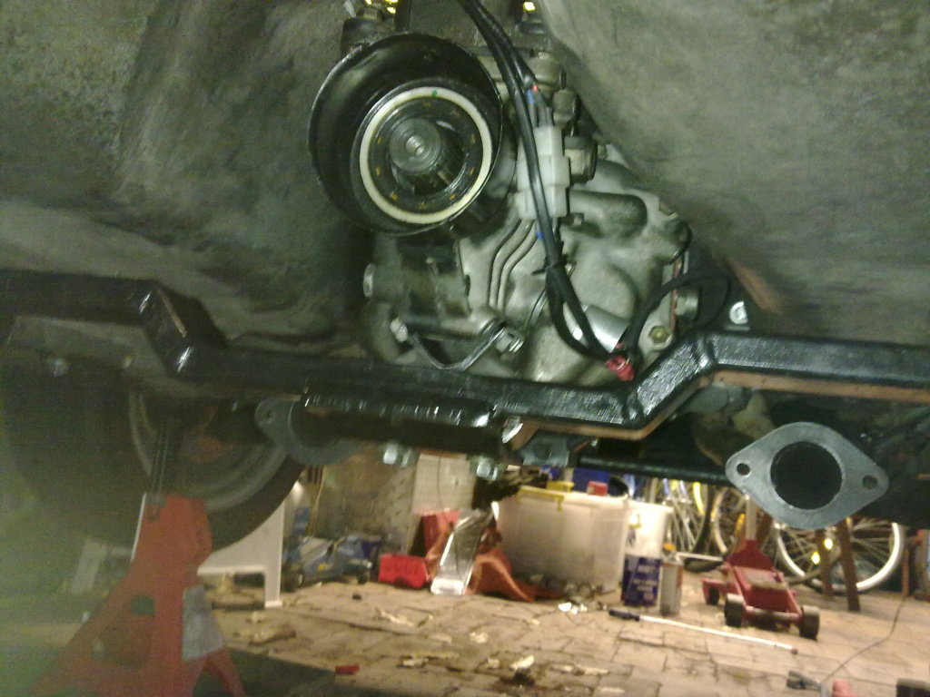

Hear are some pics of my conversion, for all those interested.

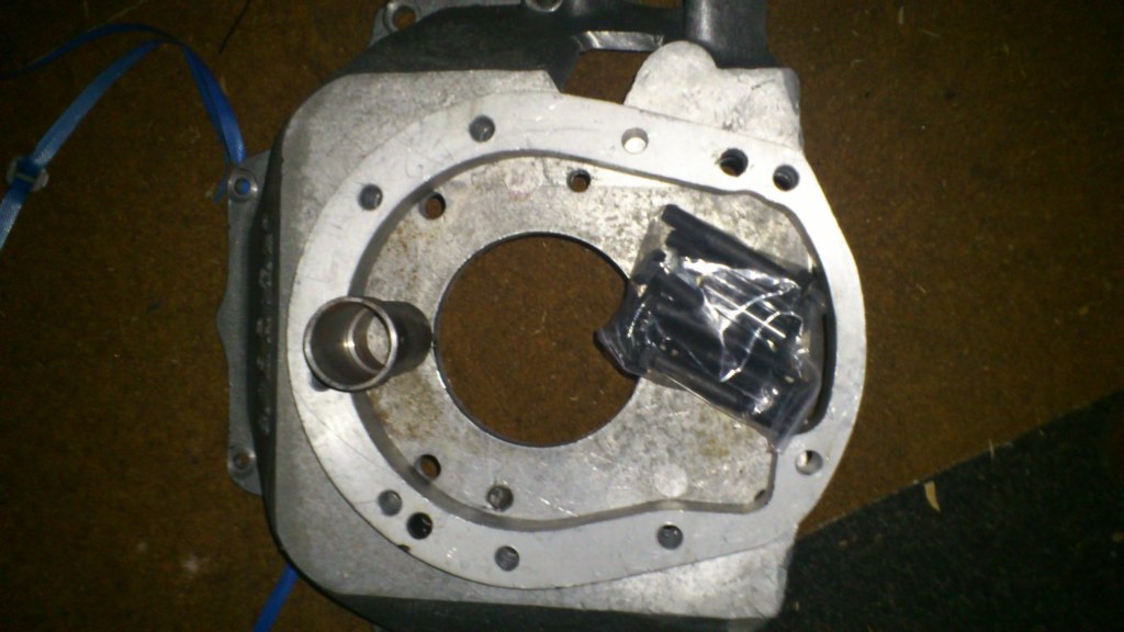

The bellhousing is a CRS celica housing redrille to suit the billet spacer and R154 box (note: that CRS will only re-drill their bellhousing, not dellow)
This is the spacer kit from CRS

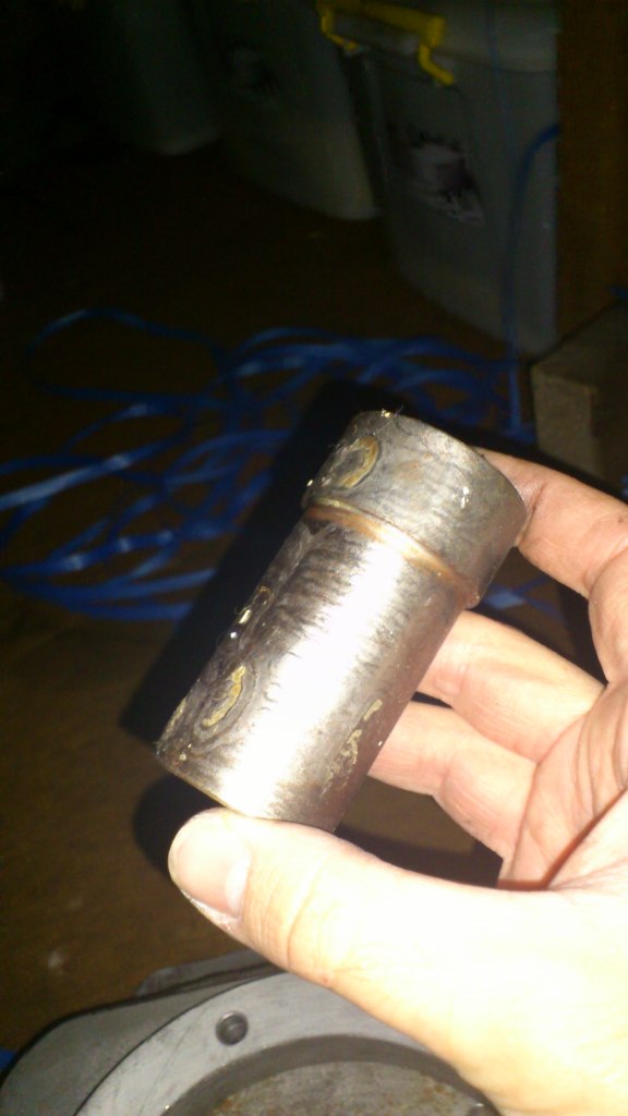

Billet spacer, bolt kit and sleeve that is tightly fitted over the input shaft. (use a big hammer and length of pipe to fit this) the throw out bearing then goes on this sleeve.
Note on the throw out bearing: CRS use a V6 Commodore bearing (from memory), in order for it to fit over the sleeve, the center will have to be machined out a bit to suit the extra thickness of the sleeve.

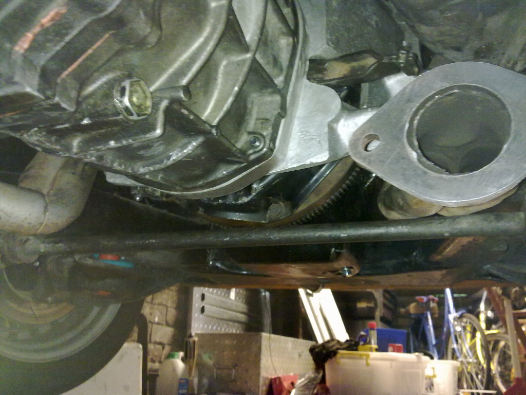

fitted in place

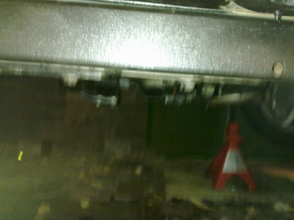

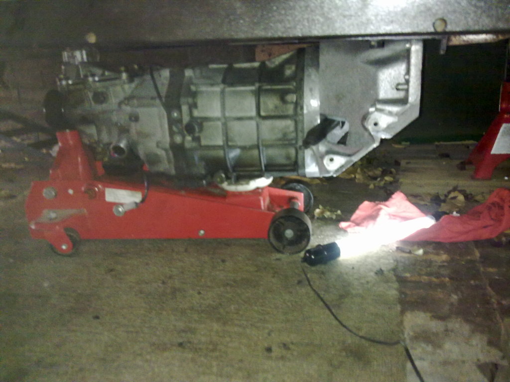

The supra box sits a fare bit lower than a celica box, (1-2 inches) so the crossmember needed modifing
The supra box was only a little bit heavier than the cast iron celica box.
