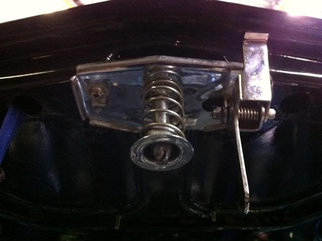

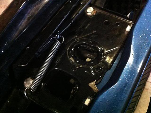

#16 _Viper_
_Viper_
Posted 20 May 2012 - 02:00 PM
Didnt get a chance to have a play with any of the above suggestions yet, but I did grab a couple pics.
Still got 2 springs on there, can anyone spot anything wrong?
#17 _nial8r_
_nial8r_
Posted 20 May 2012 - 02:37 PM
Clint on the bottom striker plate there should be a bit of movment if you loosen off the 4 bolts and move it across a little bit allowing the catch to grab a hold of the penis abit firmer and see what happens ;) or even the penis plate, there should be atleast 5 - 10mm if both are moved. i think its just the fun part of fine tuning like gaps in doors, bonnets etc. lets us know how you go
#18 ls2lxhatch
  • 5,334 posts
Posted 20 May 2012 - 02:43 PM
I does not look like the catch plate lever/mechanism comes across far enough into the hole, could just be the picture. Mine is about 6 mm into the hole.
Sliding the catch to the left as nial8r suggested will help. I would take the spring and washer off the striker/dick and check the alignment with the catch then refit the spring and washer.

#20 _Viper_
_Viper_
Posted 20 May 2012 - 03:42 PM
Yeh I tried to move the bottom plate across, even filed out the holes about 2mm
Top plate was already across as far as it could
