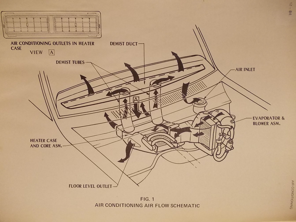

The hurricane A/C unit at http://www.oldairproducts.com/catalog/ is defintely more compact and the ducts open to the front which would make hooking up to the side and floor vents a bit easier but it is a bit boxy looking. Damn I can't decide now, I am still waiting to get the quote for the vintage air gear. The old Mark IV cool only under dash unit is such an easy looking install option but in my experience they are a bit weak in super hot conditions and don't blow on the driver. The whole thing is not rocket science it's just a case of getting the right fit and running the pipes to the right spots. [IMG https://cache.gmh-to...LHACairflow.jpg[/IMG]
Maybe size doesn't matter ??? .... :<_<: :<_<: ... Yeah right ... so anyway darwin is the same sort of weather as Saigon and Guatemala so lots of incentive to go as big as possible (the hilux conversion is maybe a bit too crowded). Check out the old service manual schematics. I wonder if anyone is still running the old factory units? The design is not too bad, bit messy in the engine bay I suppose. The old manuals have everything you ever needed to know. Anyone need something posted let me know.
[IMG]https://cache.gmh-torana.com.au/i1169.photobucket.com/albums/r513/slaaar/LHheatercaseevap.jpg[/IMG]
[IMG]https://cache.gmh-torana.com.au/i1169.photobucket.com/albums/r513/slaaar/ACschematic.jpg[/IMG].
