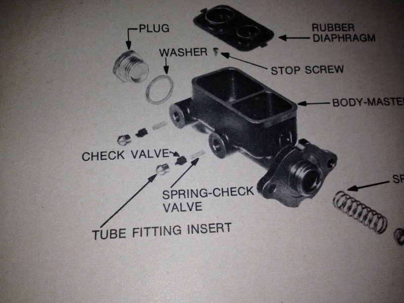

Dave, you are so helpful. Id be stuffed without some of your input. Thanks mate. This is my M/C.

#18 hanra
  • 11,015 posts
Posted 21 June 2012 - 10:10 AM
Yep. And as per this pic, it shows the rear chamber having the check valve which is for the rear brakes. Ok, so I was on the right track to start with, just that LX pic threw me.
Shame no one else here has an LH SLR with the double diaphragm booster that they could take a quick pick of the brake lines....
