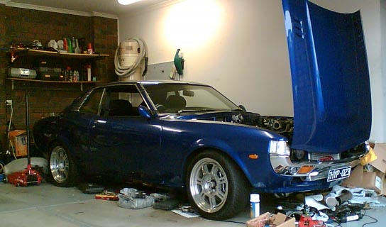

#347 turbo76lx
turbo76lx
  • 656 posts
  • Name:Glen
  • Location:Vic
  • Car:LX
  • Joined: 15-August 08
Posted 10 March 2014 - 08:29 PM
He hasn't knock back any of my other cars he has done.

#349 _jabba_
_jabba_
Posted 10 March 2014 - 09:37 PM
Reverse bonnet!!! eg. Celica
Your going to this much effort, you may as well make it sexy ;).
#350 turbo76lx
turbo76lx
  • 656 posts
  • Name:Glen
  • Location:Vic
  • Car:LX
Posted 11 March 2014 - 05:56 AM
I did look at doing that but it's so much harder to work on a car with a forward opening bonnet.
