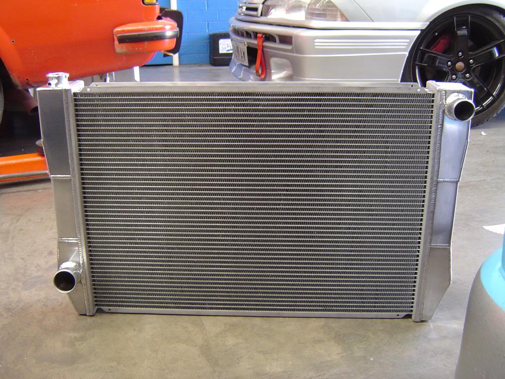

I also sell ally radiators been a radiator shop based in joondalup. The are a few option available from a Fab tank rad to a pressed tank ally Rad. Also koyo do a really good universal Rad to suit chev ford( although different fitting sizes to Holden fittings) but they are around half the price, they are all of cross low design and come in different widths.
I currently have one of the koyo universal ones at work I just got in for a customer if you keen for pics.

#10 _1uzbt1_
_1uzbt1_
Posted 30 October 2012 - 03:12 PM
this is one of the universal koy rads, they come in four different heights( which is tank to tank) in the ford configuiration which is what you need for the 308 once again with different sized fittings to the holden, its about $450 inc GST.
sizes are
482x448 (height between tanks x width between reinforce band)
532x448
582x448
656x448.
